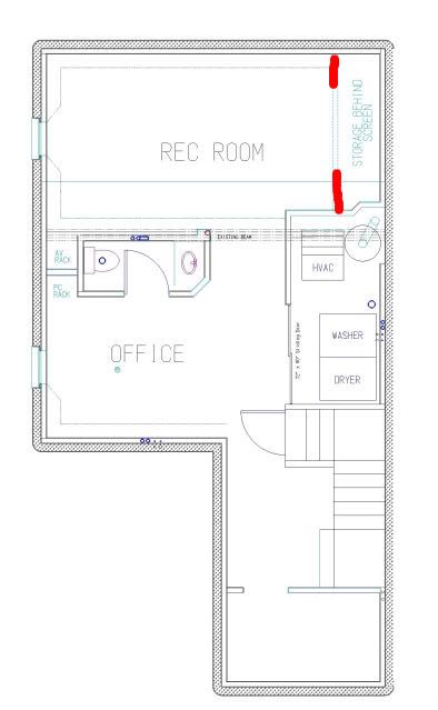

Ok, I need finalize the layout, any input on the bathrooms? Anyone have a nice little half bath they can show me a layout of? Or take pic? Or give me dimensions? help!
post #65 of 177
I'd go option 2 based on the door swing. I've got a similar bathroom on our main floor, although it is a little longer. I'm not a huge fan of the swing since you really need to close the door to use the toilet. Wait a minute, maybe that's the whole point...
But truthfully, where are you going to stand in the bathroom to get the door closed? Any chance you can put in a pocket door instead? I'll grab some pics and post them in a couple o' minutes.

I like this narrow bathroom one but I need to figure out the dimensions, I may need to go with a pocket door. Anyone have a bathroom like this one they can measure for me?
Option 2 with pocket door...no doubt.
FYI - On the pocket door kit, you need the door width times 2 plus 1 inch, for the raw frame. I've got a 24 inch door in my basement bathroom, where I just put in the pocket door. So, just make sure you plan for that part of the wall to be able to fit a 49 inch opening or more...which shouldn't be an issue.
post #68 of 177
Bhuttman! Awesome thanks for the pics!!! i take it the 8' dimension is longer the room needs to be due to the shower? I will redo my plans at 3.5' wide and check the clearences.
Jp- thanks for the pocket door tips, is the 24" door a bathroom or closet?

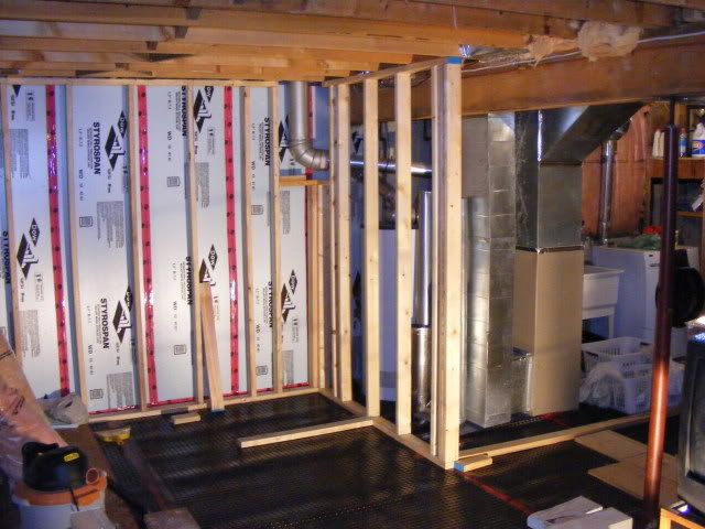

This is the framing around the exhuast vent, I will frame a small box around it later. The closet will go across where the 2x is laid on the floor, the screen will go in front of that (either hinged frame or drop down screen).

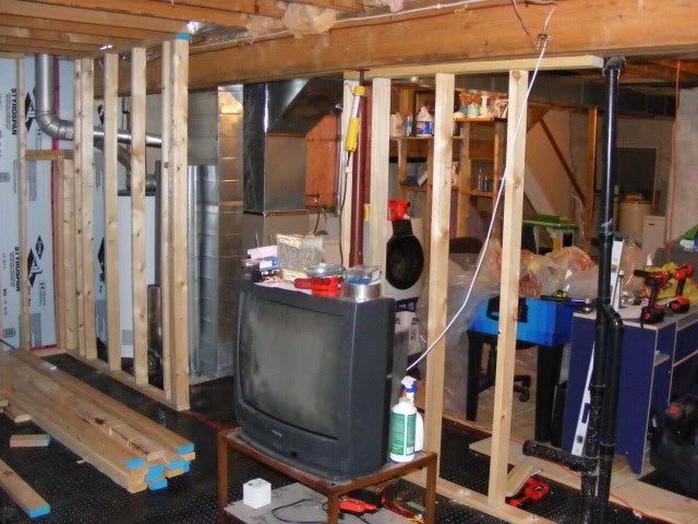

So I am in to some weird framing for my AV and PC Closets it has kind of slowed progress. Once I get past that It should be quick work framing in the bathroom, then the OSB can go down in the theater. I am trying to decide if I should lay down the OSB before or after I frame the closet/screen wall. I am thinking if I or anyone else wants make that one big room in the future it would be easier if the wall was framed on top of the OSB.
Indicated by the Red lines...

post #82 of 177
Not sure how you canukistans handle building codes, but here in MN your utility room wouldn't fly... You need 3ft clearance between utilities and in front of any access panel. Also, water sources have to have disconnect switches within 3ft if electric (water heater/dryer)
Have you checked your local building codes to make sure this is going to be okay? Where is your electrical panel? I haven't seen any mention of dedicated circuit runs or installation of a subpanel yet. Something to think about while you're still framing. Nothing better than adding an extra 18 slot 100a subpanel. (not to mention whole house surge suppression)
post #83 of 177
With the platon flooring the instructions recommend doing the exterior walls on top of the plastic platon floor and then put the OSB down with a 1/4" gap all the way around. It says you can frame non-supporting walls on top of the OSB.
I was basing my furnace room on the rule of thumb for clearance from furnaces and hot water heaters etc. The front should have at least the same distance as the entire depth of the device. The sides and front should be at least on half the width and depth for access.
This is a more recent version of the layout, the washer dryer will be stacked. So there should be more then 3ft between them and the furnace. The hot water heater is its original position. The main panel for the house is in the garage.

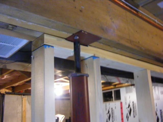

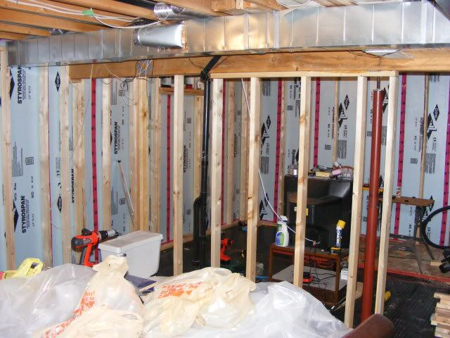

Got a bit of framing done during the week on the bathroom/ theater common wall, this shot is looking towards the rough in for the toilet, through the space where the sink wall will be.
Theater side (notice how I have gone from calling it Rec. Room to Theater). If I would give one piece of advice to anyone it would be remove everything you can from the build area that is not construction material. This TV is always in the way, and can be a distraction, plus you end up moving everything 10 times when you want to move to a new area.
Fancy Chisel work, I could have done this with power tools but my dad had brought over some of my grandfathers old tools so I decided to try my hand at it the old fashion way.
post #86 of 177

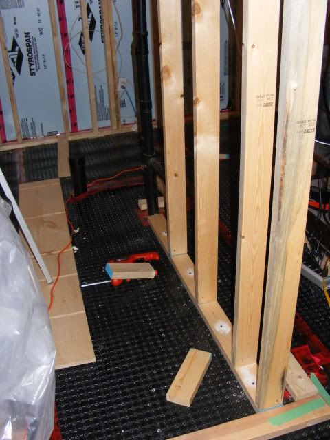

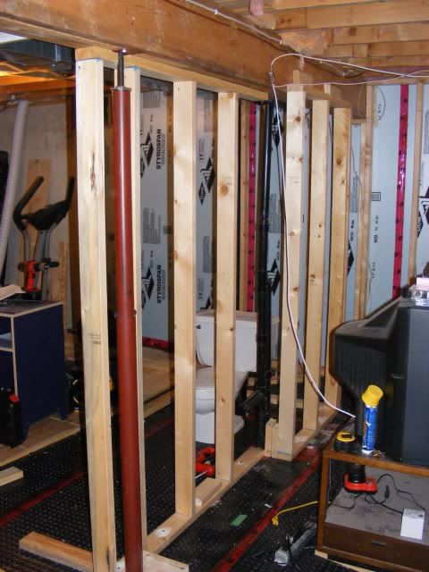

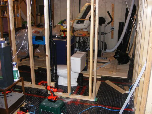

Got a bit of framing done yesterday with my youngest (2 year old) helping out. He swept and counted out screws!
I avoided a pontential critical error by placing the toilet beside the rough in to quadriple check the distance to the wall. I had made a mock up previously but somehow got it wrong after checking 3 times. I would have been short by 3/8" when the drywall was in. So I moved the closet wall back which still gives me a healthy 26" Wide x 21" deep closet. I was going to put a 21" Panasonic in the a/v closet but it looks like my 27" Toshiba CRT would even fit.
Picture from the theater side, the space between the pole framing and the box out for the toliet is going to be a 6" deep x 48" wide recess for a DVD shelf or some other storage.
Picture from the office side...

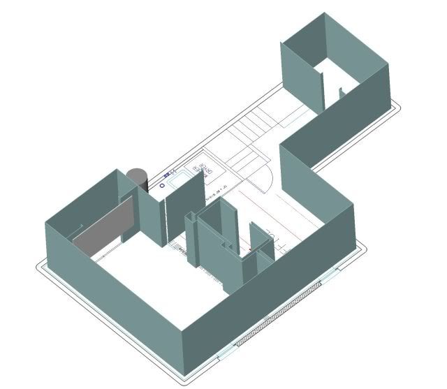

Ok, did a quick 3D sketch to make things a little easier to picture. I will try to throw in some speakers, and furniture soon.
Overview
Theater cut away with a 110" screen
post #89 of 177
