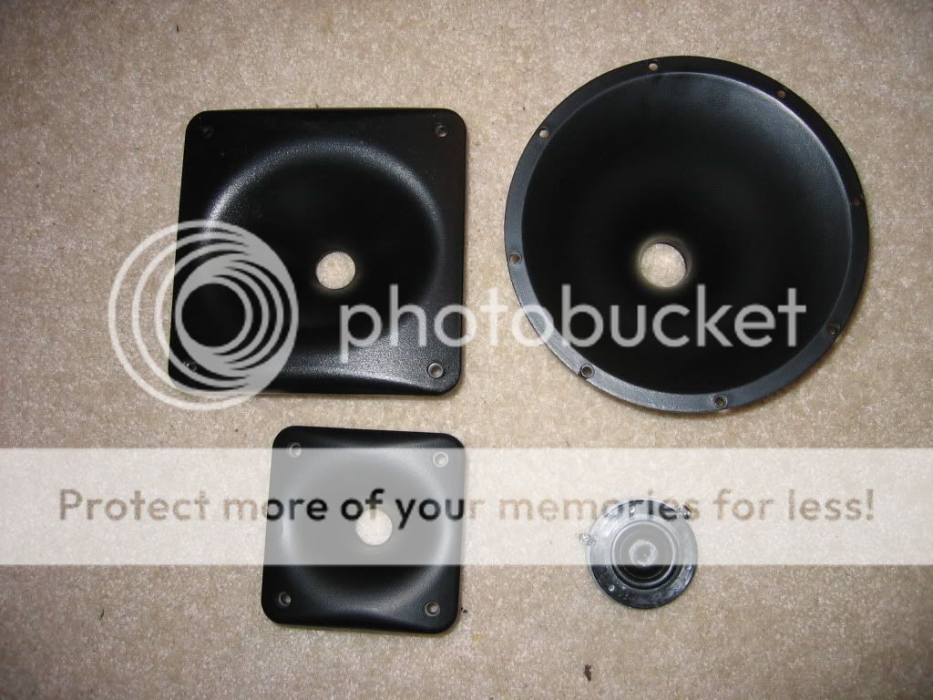

PE elliptical guides, the 8" round and the Eminence Dltalight 2510 arrived today! PIx to follow later. I have high hopes for the larger elliptical. The smaller one tapers to an ellipse too soon so i don't think i'll be able to interface it to the SB29 properly but i'll try just the same.

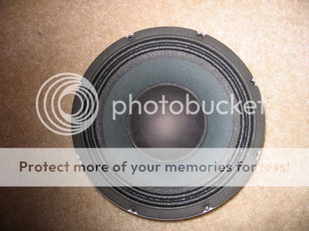

As promised, we'll start with the Deltalight 10. A pretty well made driver all around. Fit and finish are better than i expected and extremely light
The cone has a very slight blue tint to it
Notice the vented pole piece

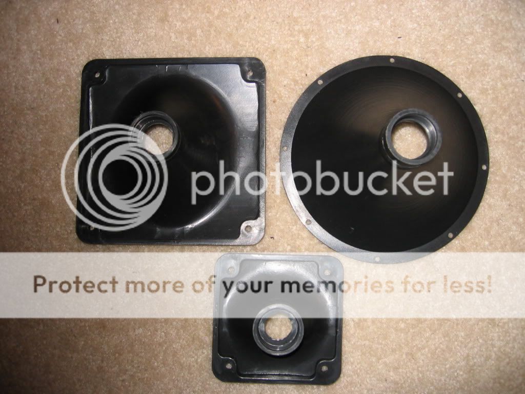

And the Waveguides
They're kinda flimsy and will probobly require some mass loading of some type
Hopefully the QSC guides will arrive tommorrow. The plan is to route a cavity into the baffle that's 2" thick just in the area that will hlod the tweeter.....faceplate removed of course. With a bit of foam behind the tweeter, should make for a solid mounting point. Then, depending on the finished depth of each guide after machining to get the opening at the right diameter, i'll mount the guides to an overlay baffle and overlay it. Just got finished cutting some MDF panels and drilling the router guide holes using a template this way everything will line up. Did a couple of thinner sheets as 'shims' so to speak.
