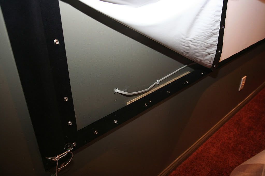

The 'normal' installation calls for power to enter the bottom right-hand corner of the Masquerade. Since I couldn't access that area, we routed the power behind the MMS screen and stapled it to the wall. Worked pretty well, I'm just hoping the staples hold so I don't get any bulges in the screen!

Power for the Masquerade run behind the screen:
