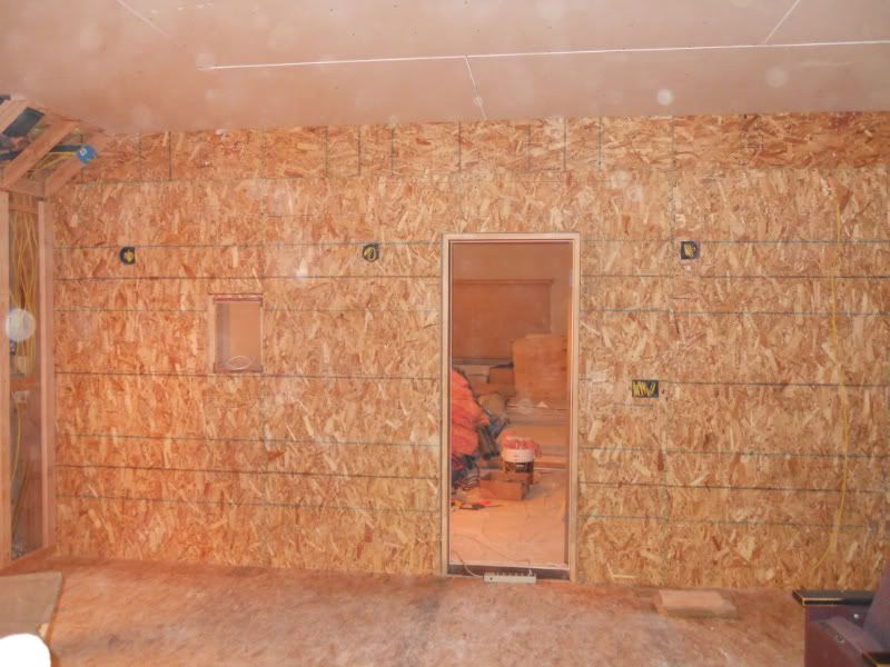

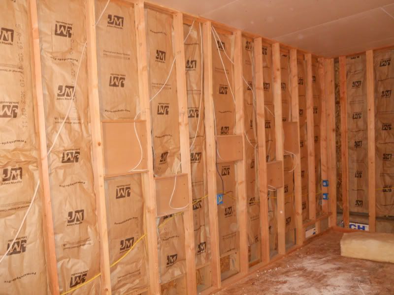

I spent since my last post until mid-August getting the rough-in electrical done and most of the AV cabling. For a guy who spends most of his time in an office, that stuff is really rough on the hands!
I call this the puzzle wall because I cut out many pieces needed so that the electrical and speaker wire could be run. Then I had to fiqure out where the pieces went to put them back and had to custom create some replacements.
After the wiring came insulation. You can see some of the first drywall on the ceiling.

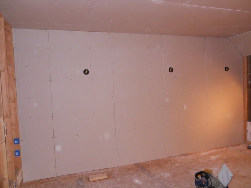

The double layers of sheetrock have been completed in the theater. I'm waiting until I get the lounge done too before starting the taping and mudding.
If that looks like alot of cables for the projector...it is. Since I had the easiest opportunity during construction, I ran 3 HDMI, 1 Component, 1 VGA, 1 Serial and 1 IR emitter.
