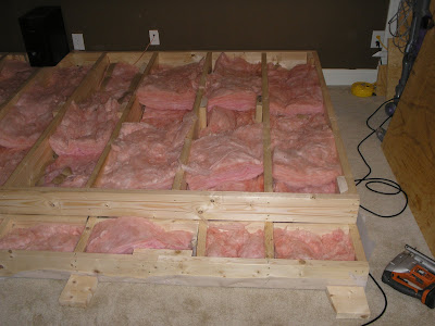

I had not realized you were not attaching the stage or riser to the floor. You are going to get some interesting sound effects from that setup. Without being filled with sand or insulation they will act like two big drums. It will make it easier to carpet though.
post #19 of 23
I still am going to fill, from the bottom with insulation to avoid those issues, and probably put a thin fabric layer across the bottom to keep things cleaner. I just don't see the need to cut into my brand new homes wall to wall carpet. That's why I don't thinks its that big a job.
post #20 of 23

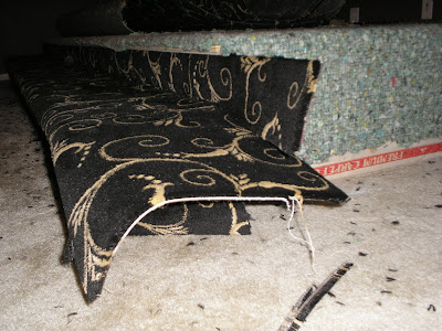

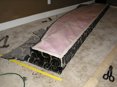

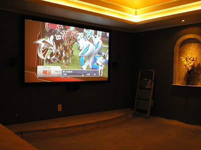

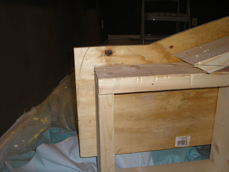

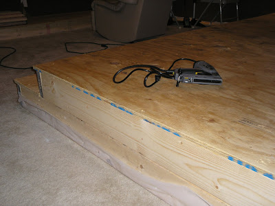

Got some good time this weekend to build out my riser and stage. I have 1 layer of 3/4" plywood, do I need two?
Some Carolina Football to keep the focus!
I need a wide angle but here's as good as I can to show both stage and riser.
post #21 of 23

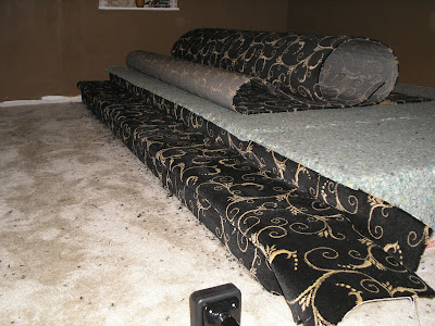

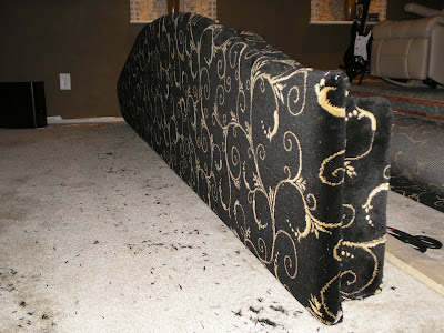

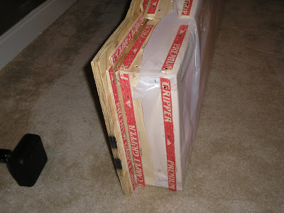

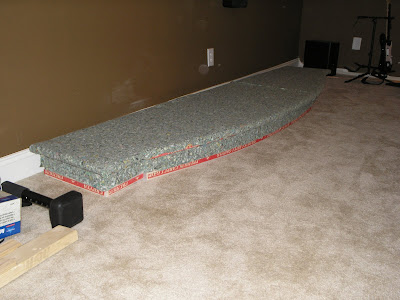

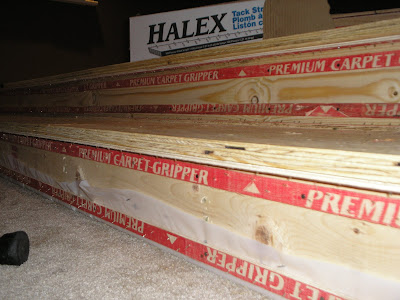

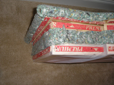

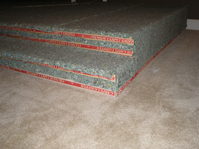

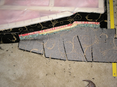

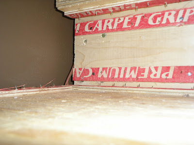

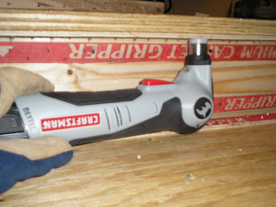

Well I talked to lowes, hd, and had found a nice remnant piece at a store and after a visit from the installer and two days later the quote to install was over $370!! Well that's just terrible. So DIY!
I found another excellent piece of carpet for a great price and I'm having them cut it into some smaller pieces that I measured twice!
I picked up my tackless strips and padding and went to work getting ready.
I think I'm ready for the carpet!
post #22 of 23
Looks great....I choose to do my stage and riser differently. I didn't put any of the tackless strips on up-right or the lip as you did, but I bought a $70 compressor set with a pneumatic stapler included and just set the setting to high and staple directly the carpet to the vertical and lips (no padding there either). Then I used the teeth carpet roller to cover any evidence of staples. Came out just as I expected. I debated a lot if to go the route you did, but I guess the end results is what matters. For a room that is mostly dark I was will to take that direction.

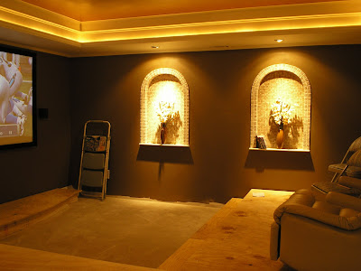

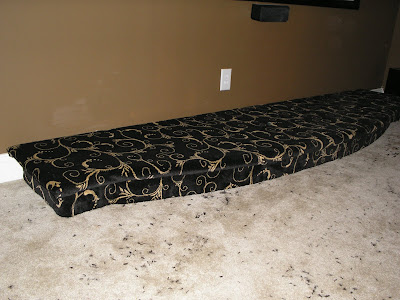

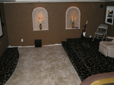

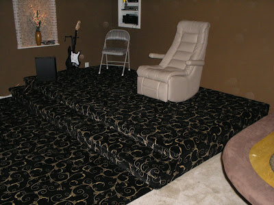

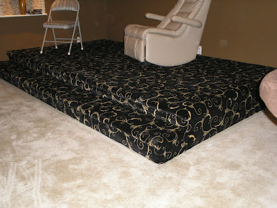

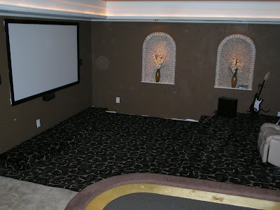

Thought I ought to finish up this thread with the end product of my self carpet experience..
little trim paint to finish up
Now its time to price out the Berkline 45030's and the beer fridge!
Thanks for all the input! Feel free to come on over for Poker!
