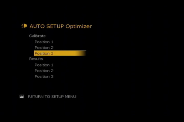

Originally Posted by sdurani View Post
In that case it might be worth it to do separate measurements using the +3dB and +6dB curves, storing them as Position 2 and Position 3 (respectively). Can be done during initial setup, since there is no need to move the mic between measurements. This way, you have all three curves at your disposal; can even assign them to different inputs (keeping all other parameters the same) to easily bounce between them.
Sanjay-
I don't recall if the positions get erased when the +3 or +6 files are loaded. Let us know if it works... and I'll make a note in the User Notes.

post #1245 of 2724
It takes more time, but it can be done.
When you go into the Auto Setup screen, you have a choice of which position to save your upcoming measurement as:
Select Position 1, start calibration (measurements), if you're happy with the results, run computation, finish by saving the settings, the receiver will power off.
Update the receiver to the +3dB curve, select Position 2, start calibration, run computation, finish.
Update the receiver to the +6dB curve, select Position 3, start calibration, run computation, finish.
Apparently it saves measurements/results/computations for three independent positions, because...

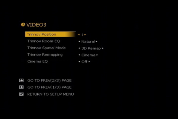

When configuring each input, you get to specify which measurement position to use for that input:
Manoj (adude) has his 972 set up this way. So it works.
Originally Posted by vinodk View Post
But aren't you supposed to reset the unit after loading the sub boost file which will essentially erase all calibration settings. Jin from tech support also informed that boost files boost low end for all channels below 200hz.
Originally Posted by cschang View Post
So it seems like the reset is not needed after loading the files?
I will try it tonight.
I just talked to Manoj(adude) and it seems like the reset after loading the new curves is not needed.
I'll be doing Sanjay's suggestion tonight.
post #1250 of 2724
Also try using the Natural curve. I helped Ken (RUR) set up a 972 at a friend's place recently and thought the Flat curve sounded a bit thin. Natural sounded a little closer to perceptually flat, though I still think the bass needed more boost to get there.
post #1251 of 2724
Will do.
