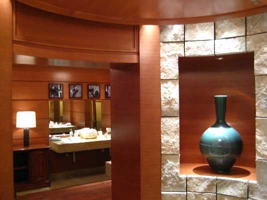

I'm going to use this post as a bookmark for myself. Thanks CJO for providing a great example. But I'm just going for the free flow...
Best representation of style
I love the wood treatment in Steve's theater (swithey). This photo shows the combination of that wood tone and some tile work we saw while in Puerto Vallarta recently. Not sure how I'm going to incorporate them, but this is the goal (of course with more black

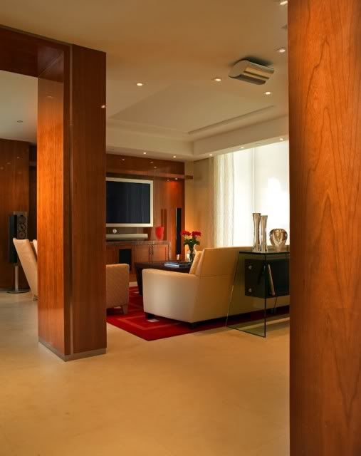

Here is the column style, and wood species/finish that I'm after:
I like Steve's grooves with metal inserts. But I might just go with grooves. The grooves in the wall in this pic have nothing but stain, while the bar has a painted accent.

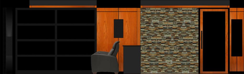

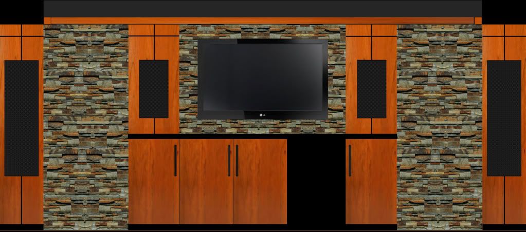

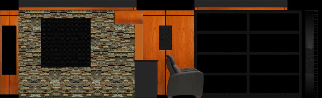

Current Layout
Screen Wall
Left Wall
Right Wall
Rear Wall

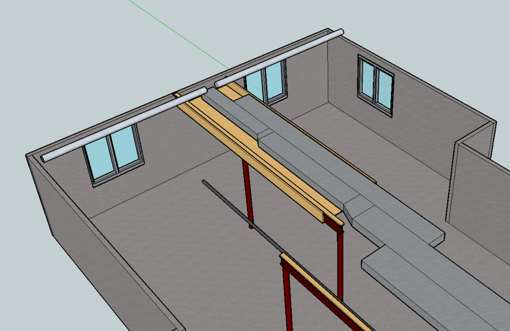

Zen Master, what ceiling heights are we talking about under the joists, the beam and the ductwork.

Unfortunately it is exactly 8' from concrete to joist. If I decide to do as Ted has suggested (RSIC-DC04 to attach walls to joists, whisperclips and channel for ceiling drywall, no clips on walls as they will be decoupled from the rest of the basement) and a subfloor of about an inch I think my finished dimension will be between 7'8" and 7'10".
Your timing is taking a universal drink of nature...flowing as the river runs. This weekend I will be extending my mind clearing exercise to the clutter clearing in the basement.

Beam: subtract 9 5/8"
Trunks: subtract 8"
Ask and you shall receive...
And yes, I measured all the joists...
that may not be exactly in the Zen tradition. But hey, all that anal stuff is what got me to this point of accepting things the way they are.

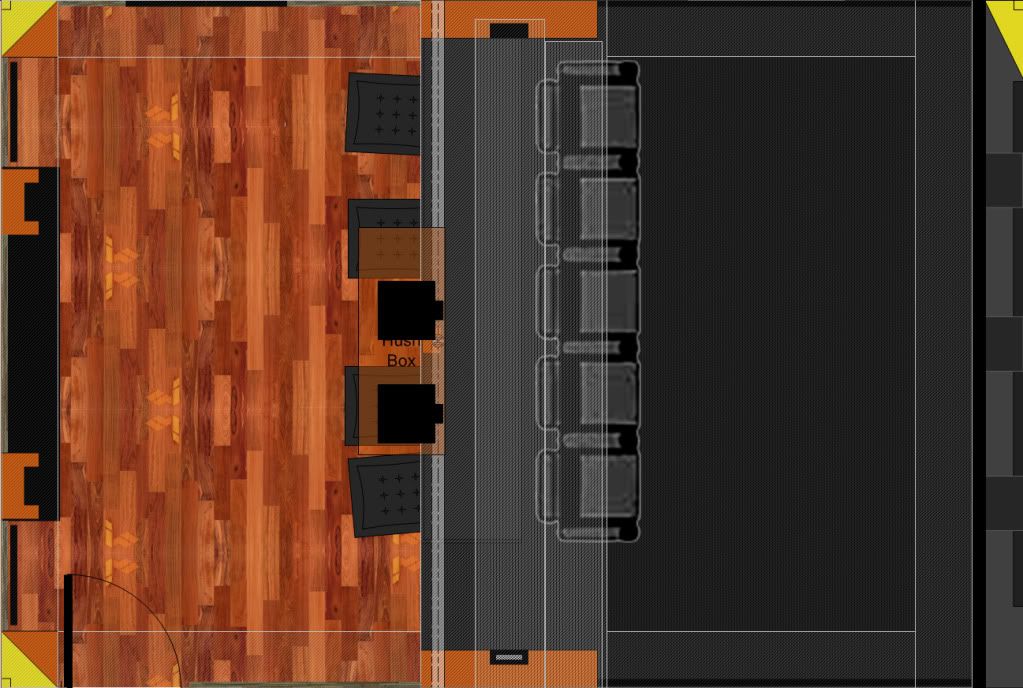

Floor plan? I've scrapped at least 10 Visio plans, more than 10 hand drawn plans, and at least five Sketchup plans. Do I have a current one? Maybe I'll share it this weekend after some cleanup.
The plans are one of the reasons I'm embracing the stillness.
Breathe in, exhale....breathe in, exhale....now, I want you to go to your happy place. All is calm, turbulence is no more.

Here is the most recent revision...

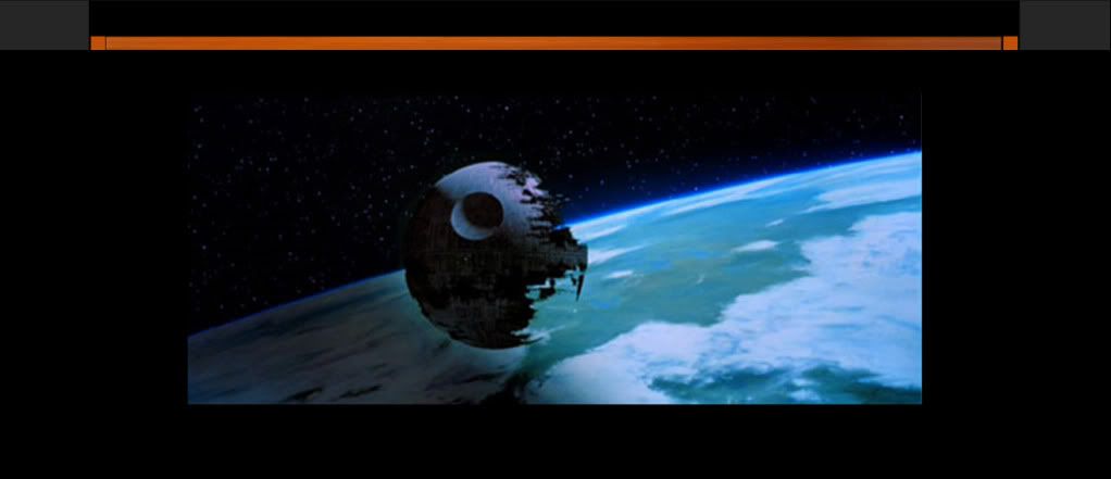

I think my biggest problem will be getting a 12' wide scope screen with the throw distance constraints. That @!#$%@#$ pole is really killing me. Wait, no it isn't. In fact, I like that the builder decided to support my house. The pole will now become a focal point in the room. I am at one with my pole.
Now that I am peaceful again, what about those doors? The wife really wants it open, if not then french doors. Will I gain any isolation at all by using a pocket door plus the french doors?

Audixium,
One suggestion (at least from my experience)... We actually planned to do the bar seating in the back in our room and changed it to traditional seating in the end. We figured that for a 2-3 hour movie, the bar seating would get a bit uncomfortable. AND, you being the nice host you are, would let you guests sit in the money seats while you sat in the "less comfortable" bar stools.
So, I took the liberty to beat up your floor plan and make a few changes for you
Of course, this is only my .02 -- so it is in no way binding
Change 1 -- use regular club chair type seating in place of the bar stools. Raise the floor about 10" or so to clear the heads of the people in front. I know that your ceiling are only 8', so it will bring the ceiling in a little closer. I would think that unless you normally have NBA pros over for the game, you should be okay.
Change 2 -- Add some lower bar stools in the back to "pack 'em in" when needed. If the club chairs swiveled, it would add a nice conversation circle. Case in point -- typically the men sit in the front while the ladies sit in the back during a football game. The ladies talk while the guys watch the game and yell at the screen.
Change 3 -- Added 2 more bass traps in the back left and right corners. You'll need them with the 2 sono-tube subs you'll have up front (and of course we'll need to talk about a few DIY monster subs down the road!!)

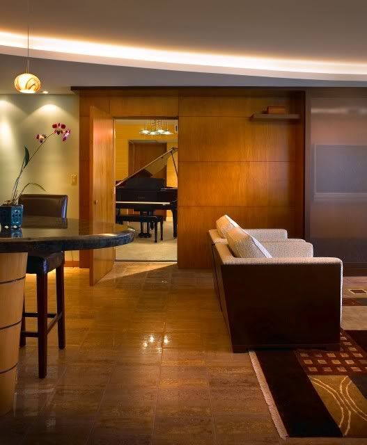

Love the look your going for. We did cherry in our room as well, its so warm and inviting. couple quick ideas...
-In my mind recessed cans are pretty non-zen, so how about some of the new low volt pendants for the bar lighting? They have a real warm(aura, not temp) light and ultra cool glass fixtures on the end of the single wire that holds them. placed at the right height they could really provide great lighting and still be out of the line of sight, and since they attach to regular electrical boxes they are way better for sound isolation then those troublesome cans? not to mention giving you great options for coordinating sconces...zen, baby, zen...
-then how about a cool cherry framed fabric panel for the windows? you could find a cool rug or tapestry and frame it with the cherry and it would help with acoustics too...hey you could go so far as to build it into a sliding frame and be able to slide it out of the way for some natural light during those times when you don't need utter darkness.

Originally Posted by swithey
Audixium,
Audixium,
Thanks for reminding me about this. I had originally planed to use black leather office chairs like Big Red. He mentioned that they were great in his back row with the bar.
Agreed - I'll update the plan with a riser and chairs.
I'm still not sure what to do in the back area. I thought a walk up bar against the wall might work. At one point I had a poker table type setup in the upper left corner. That seemed too crowded. I need to clear my mind again.
I should consider the guests. I'll put more thought into what I can do there.
I had bass traps in there, but can't figure out how to cover that area while making it appear like a design element....?
DIY subs? Ha! Surely you have me mixed up with someone who likes MDF dust.

Originally Posted by GarenT
Audi,
Audi,
Thanks for the link! I like the look of these:
I've also thought about going with LittLites like indygreg did for his back bar in Big Red
Garen
Garen
I have some ideas along those lines. But I had not thought about sliding like a shoji screen effect. That might work out to be really cool!

Do you have any elevations to share with us (front, back and sides)?

I think that is a good idea. I was toying with making that area something like that - walk up bar that could also be used for what you describe.
I was planning on two SVS subs up front. But now you have me wondering...could I convert the two columns on each side of the front row into subs in the bottom portion
? I have them at 12" deep and about 5' wide. Would that kill any attempts at isolation?Quote:
Not yet. I learned not to start on those until I'm completely, conclusively, absolutely, universally committed to a layout. Once I am at one with the layout I'll elevate it.
