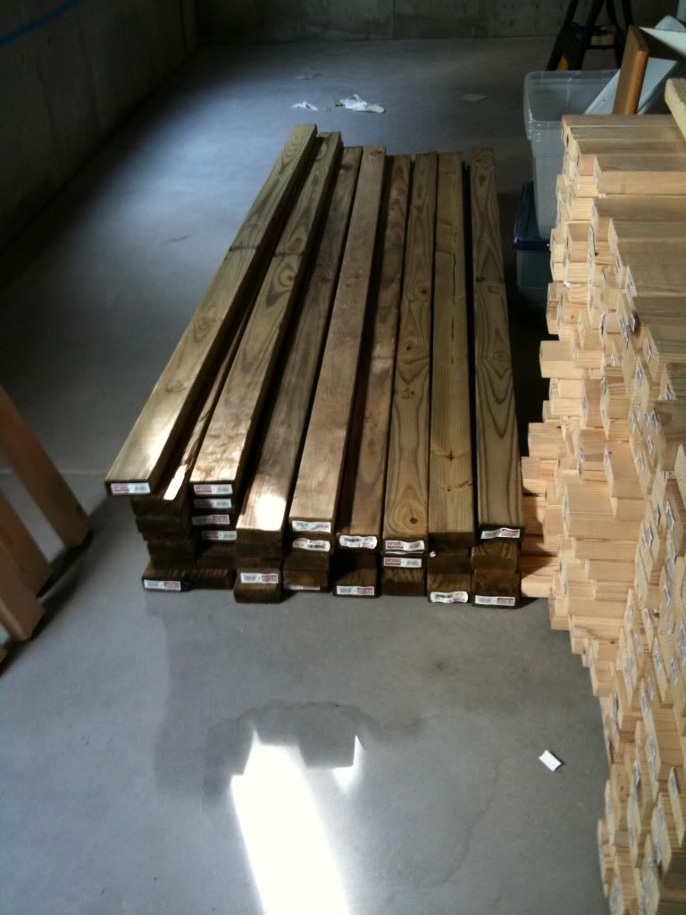

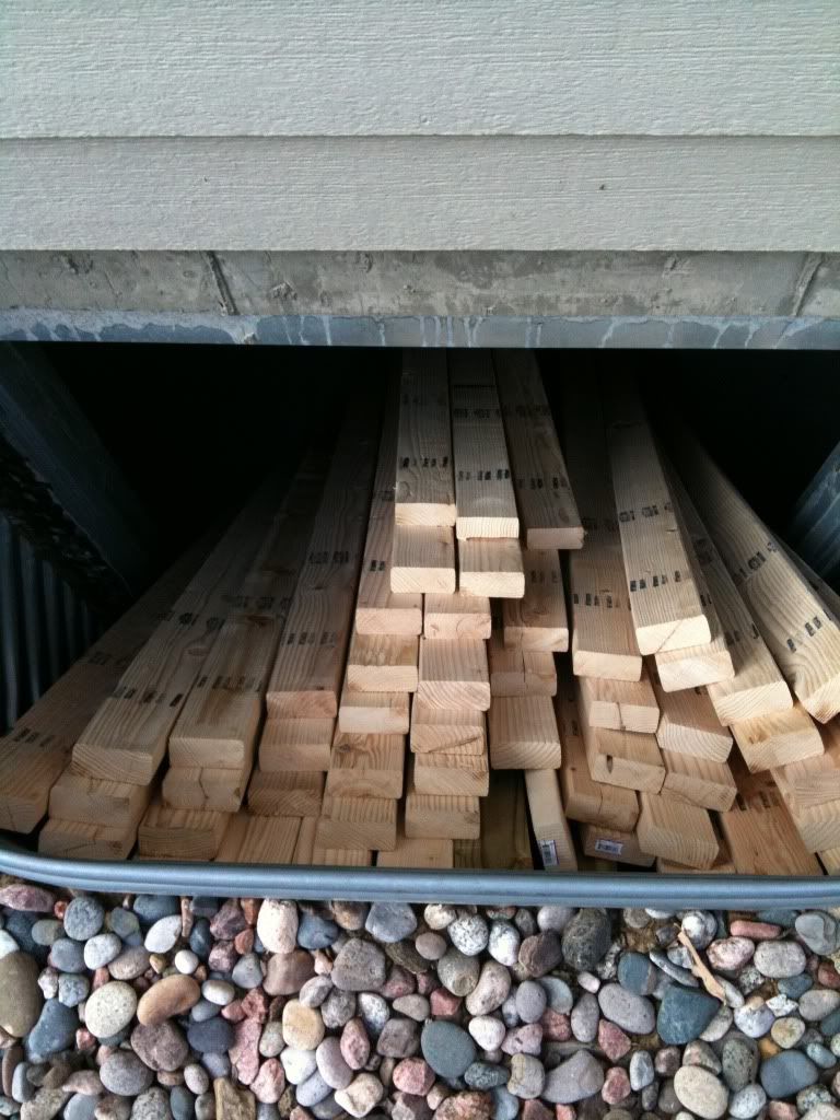

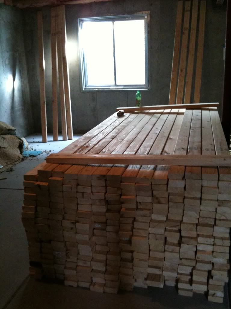

Today started out great! Lowes delivered and unloaded the lumber by 7:15am. It was all down the hatch (photo below) by 10:00am. The UPS man showed up with the DC04 clips at 10:30am - he never shows before 3pm.
As delivered
"The Hatch"
The Hatch is now clear
The Stepchildren
It was all happening like clockwork.
