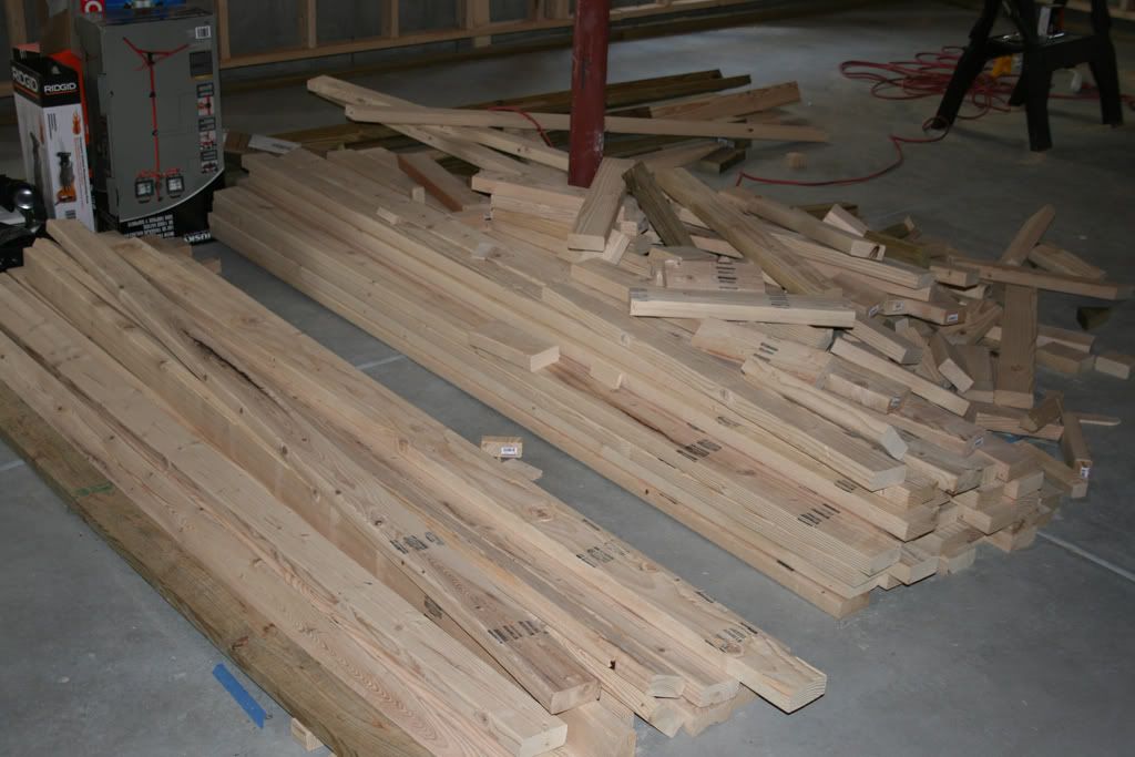

So I went into the hole today and spent a good hour cleaning up. I was really good the first week of the build - cleaning up after every session. After that, my tools learned to be at one with the last place I left them. Now everything is back close to its place, the inch of sawdust covering the concrete is corralled into bags, and I'm ready for another session of turtle progress.
For some odd reason the cat keeps stealing spent framing nails and putting them into her water dish. MIL thinks its a sign she has an iron deficiency . She also steals drill bits and screws. I guess I should clean up more often.
I measured the rough framing dimensions:
17' 7" wide
27' 0" long
8' 0" tall

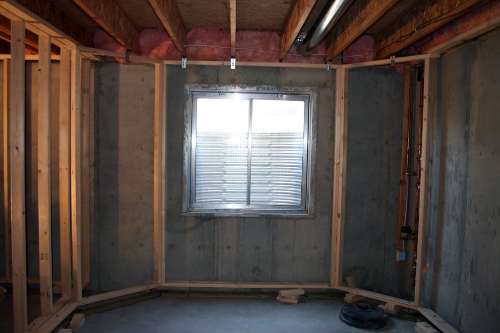

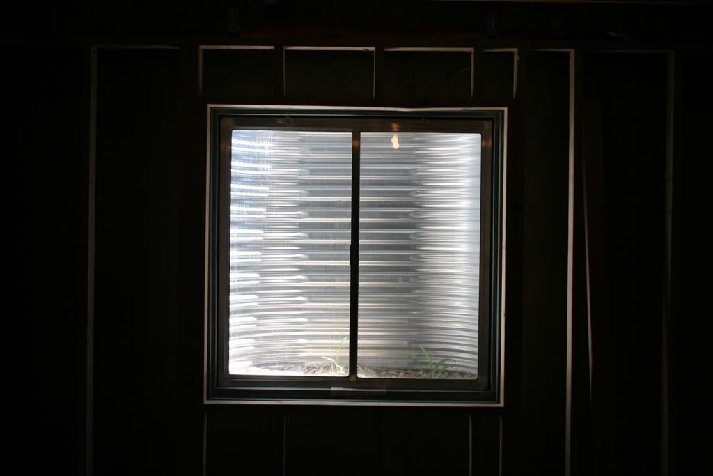

Here is one of the windows in the theater. Class, who can tell me what is wrong?

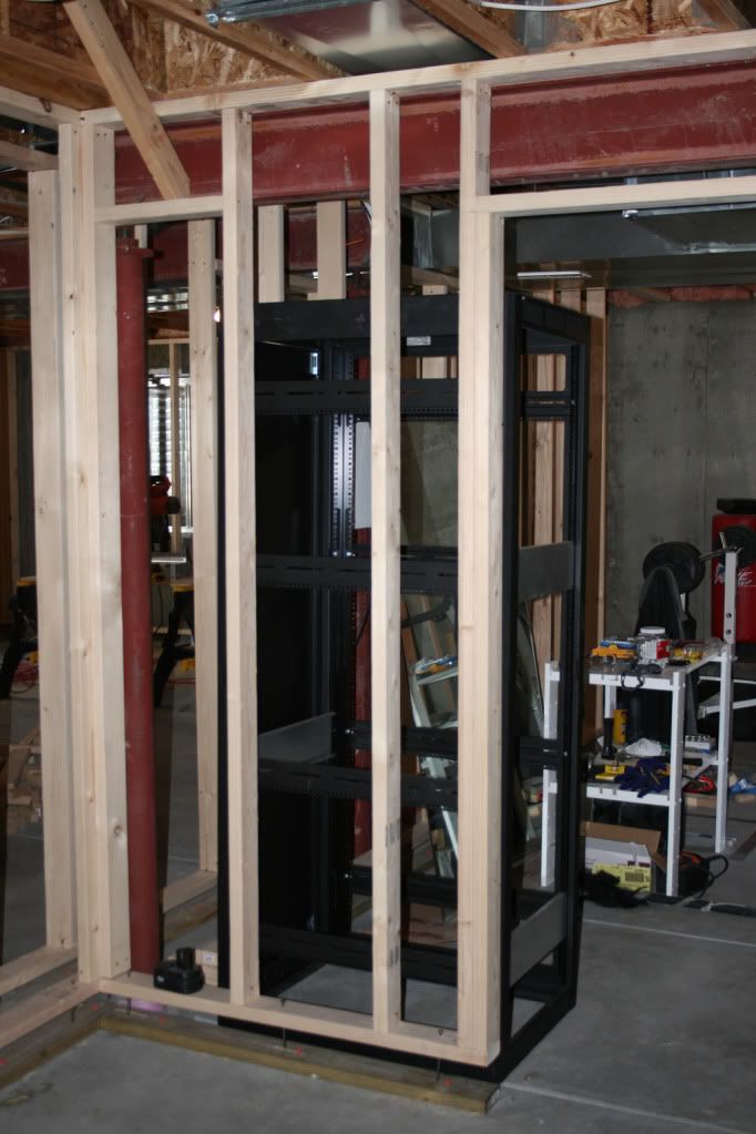

Rack - back to the decision to not expose the rack. I'm just going to keep it in the mechanical room and not expose it in the wall. It's a good thing I left enough depth. I think this will also help with the isolation.

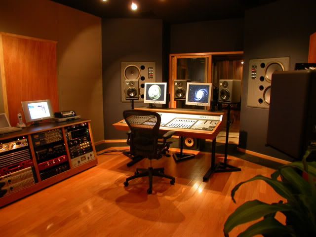

Control room - as I previously mentioned, my build includes the theater that can also be used as a tracking room. A lot of the acoustic principles used in theater design apply in control rooms. However, when you go small like mine there are a number of room mode issues to work out. Because I'm not going to be selling my services I'm not being overly critical.
Here is the closest representation to my current direction for the control room. However, I won't be soffit mounting gargantuan monitors like in the pic.

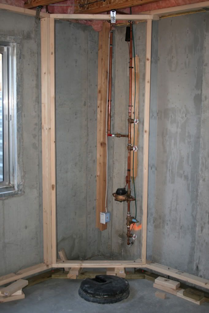

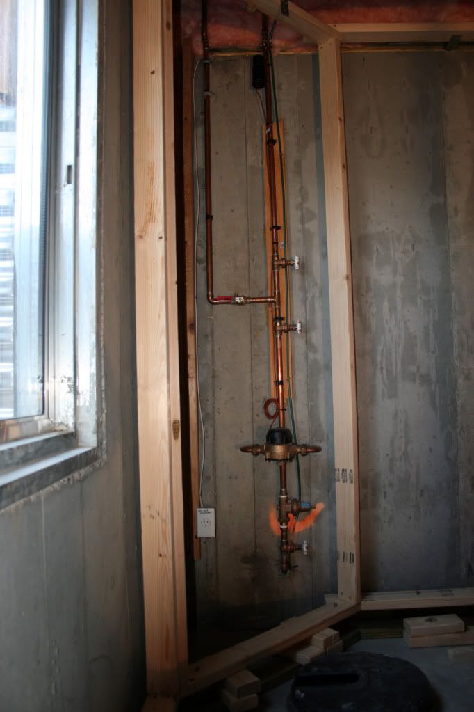

I started framing the front wall. Note the water main in the right corner.
Obviously I must provide access to this entire area. So I plan to build a thick MDF door on hinges with double seals to allow as much isolation as possible. It will be almost the entire width and height of the rough framing. Lot's of high frequency coming out of those pipes when someone turns on a faucet, flushes, showers, dishwasher or washing machine kicks in, etc. Luckily most of my time down there will be when everyone else is in bed.

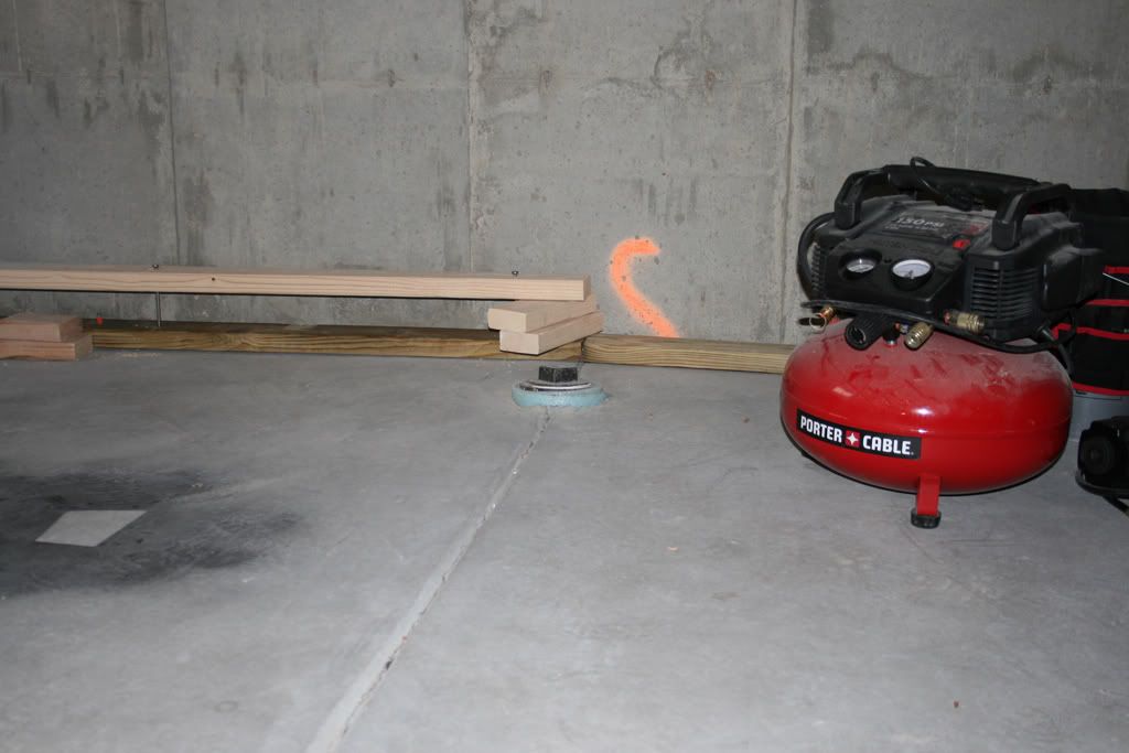

Note: there is also the infamous sump pit. I plan to block it in with a removable cover - again with thick MDF and double seals. I'll do the same with the main cleanout for the entire house.
