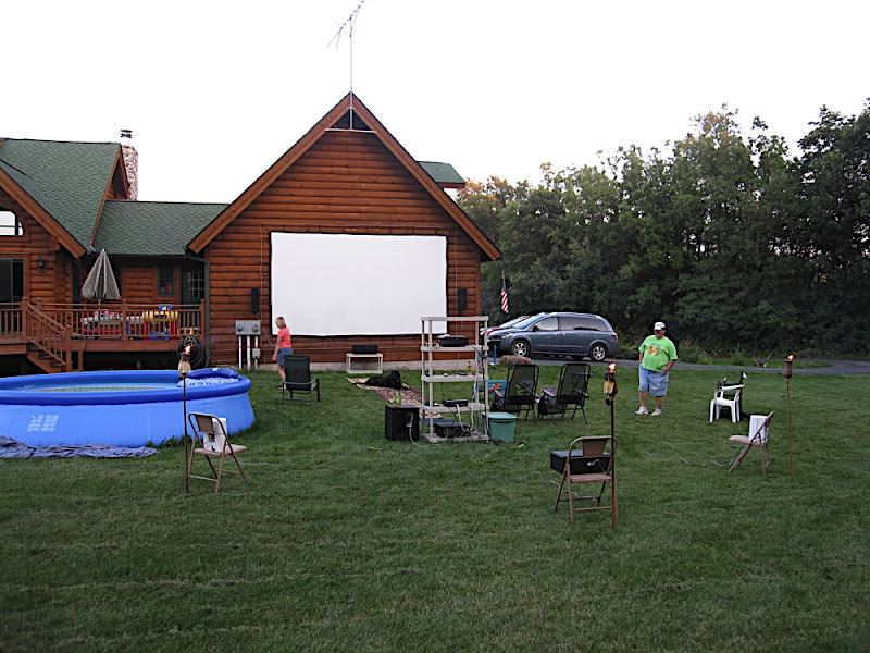

BTW, my idea of an "ideal" room is a free-standing shed in the back yard having walls made of cardboard. Then you'll have no bass reflections at all!
--Ethan
Or an open backyard home theatre??
Just a front wall and floor - grassy floor
I moved the sides/rear speker closer to seating zone upon testing, and was very happy with the 6.1 sound with the 16' x 9' image.
btw;
great educational thread
