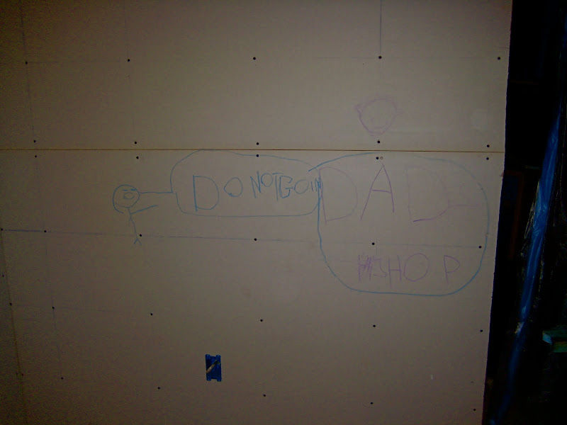

Okay, drywall is up, waiting for mud... then the fun begins- building the entertainment center. Hopefully my PJ will come in this week or next, I need to figure out how big of a screen I can get, and then finish the design of the entertainment center. I'm going to put solid panel doors on either side of the room to help contain the sound. I'm itching to get down there with the speakers and give the room a run...
Front wall
Rear Wall
And for fun, my 5 year old wrote this on the wall that backs up to my woodshop. I've had this drywall up for a while, trying to keep the dust in. I told him he could write in chalk whatever he wanted. It's hard to read, but it says, "Do not go in. Dad's Shop."
