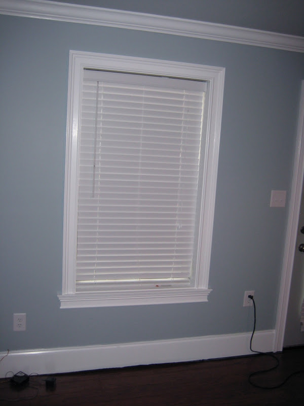

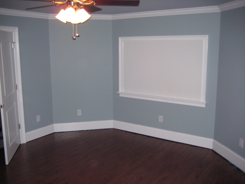

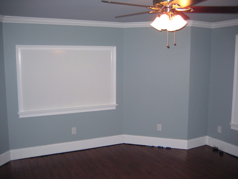

Okay, not much progress on the media room, but I've finished the first room in the basement. We wanted to turn the one room with windows into a school room. My wife is a teacher by trade, and we're going to keep the kids home for now. I'm posting pics because it feels good to make progress. The trim, paint, floors (Pergo) were done by yours truly. And now I'm going to hire out the rest of the basement, I just don't have the time. I feel like I've spent every spare minute in the basement for the past 4 months. I still have to do the toe molding.
The blue didn't come out well in the pics, the camera picked it's own shade of blue- the real color is more of a slate blue. The white board is a sheet of tile-board trimmed out with casing, makes a great custom grease- board.

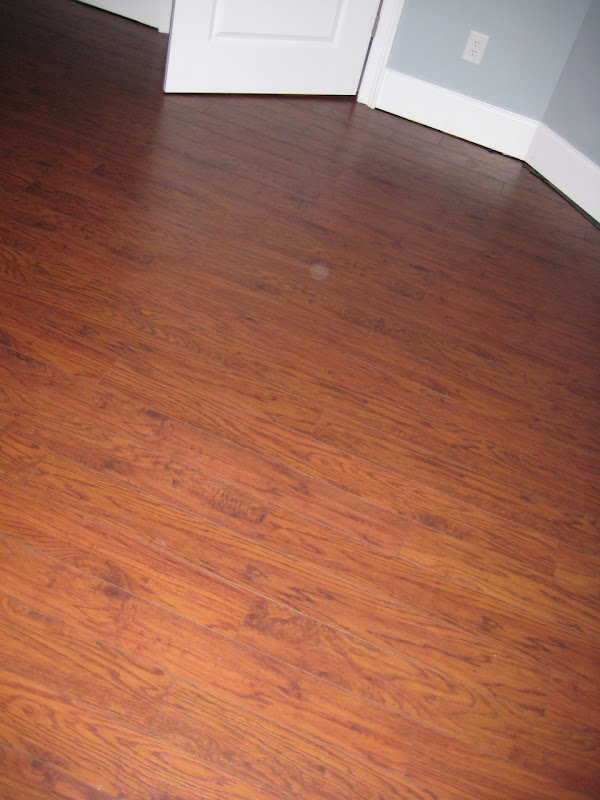

We went with Pergo laminate for the floors. We didn't want to fool with solid wood in the basement, and after comparing engineered wood to the laminate, we felt like the laminate looked just as good (if not better) and was much more scratch resistant. Just a little cheaper too. We'll use the same flooring in the kitchenette behind the media room.

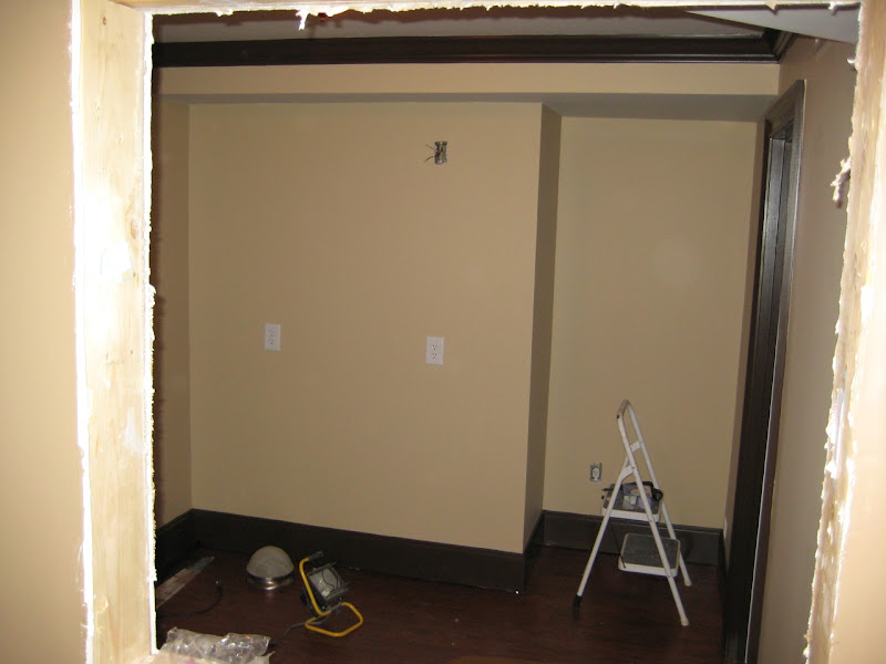

Okay, trim was done today. I selected a painter today as well, and hopefully we'll have paint up next week. I think I'm going to miss the superbowl, but if I can get the carpet in, we're going to stop for a while, and I will go ahead and set up the system for the olympics while I work on the entertainment center. Cabinets and bathroom stuff will continue in the background.

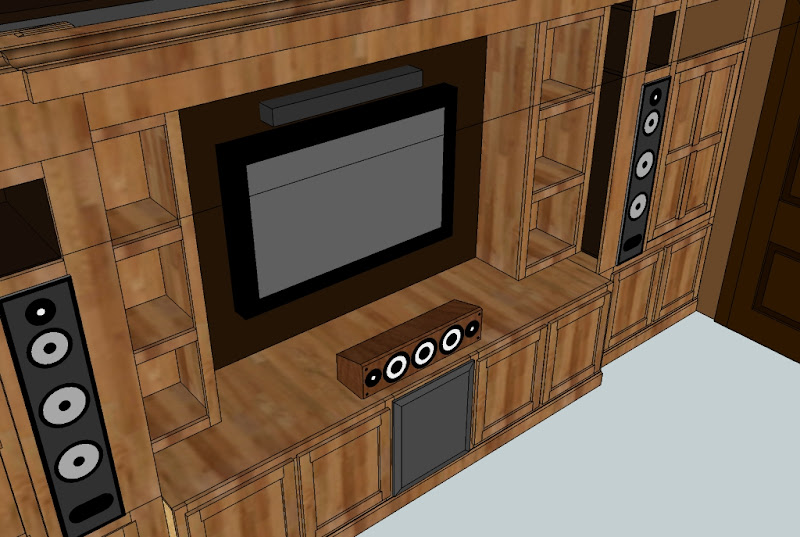

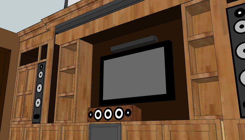

Here's the Sketchup mockup. I posted some off angle viewing as well to show some of the dimensions. There will be pieces of trim here and there covering joints and seams, not worth the effort of putting into the model.
The first is what it will look like with the screen up. I can't decide if I want to paint the inner area black to better conceal the TV and speaker bar above it (for everyday, simple viewing) or line it with 1/4 plywood to match the wood. I think I'm going with African Mahogany, it's as cheap as maple right now. The AV rack will be installed behind the door all the way to the right. It will be a pocket door and will be open during viewing. The sat box will go in the cubby up top. It runs continuously and will need ventilation. There was no good place for an AV closet.
Next is the screen down. Da-lite has 3d models of their screens. I used the 106 and stretched it out to 110 diagonal, it's not perfect but easier than building my own screen. The casing will be recessed behind a hood with crown. The sides will also be partially concealed by the trim flanking the speakers. I'm hoping this will create a bit of a shadow box around the screen.
Looking up into the hood.
Looking down
Next, I need to make cut lists for the plywood and solid wood so I can minimize waste, and then build up the courage to buy all that wood. This will be the largest woodworking project I've tackled.

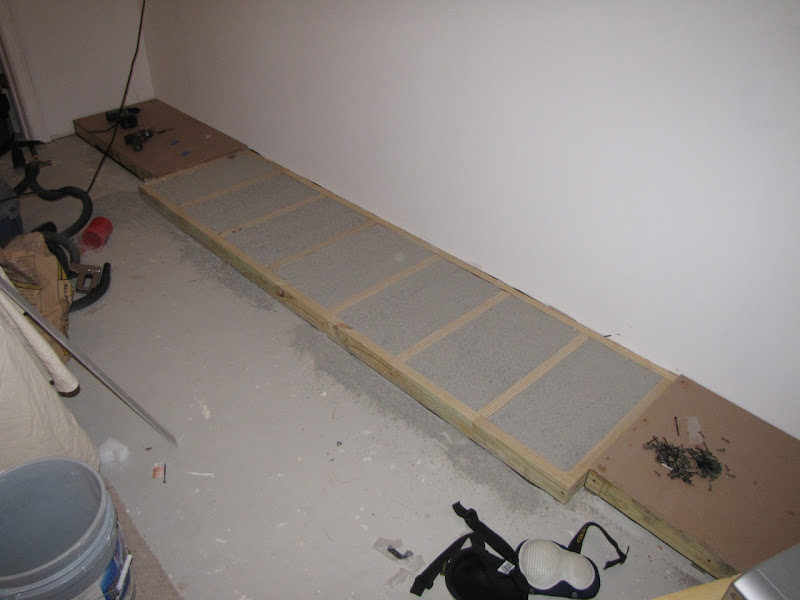

I did finally start on the entertainment center. The base is 2x4 pressure treated pine. I wrapped it with 30lb felt to keep it from vibrating on the floor (although I had to raise the front about 1/4 to level it off, so I don't know how much is actually on the floor). I filled the base with sand (630 lbs to be exact) to deaden sound and then a layer of 3/4 MDF on top to be sure everything is as dense as possible. It's about 1/8 off the wall behind and 1" from either side wall, so hopefully will provide a good, isolated base. It's also wrapped in clear plastic (can't tell in the pics) to keep the sand from trying to creep out or through the felt.

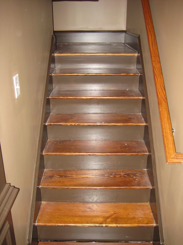

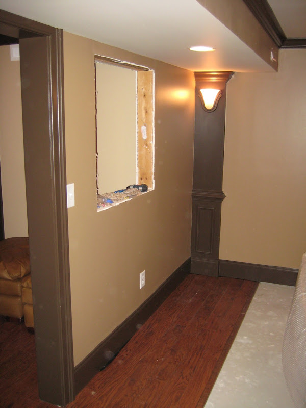

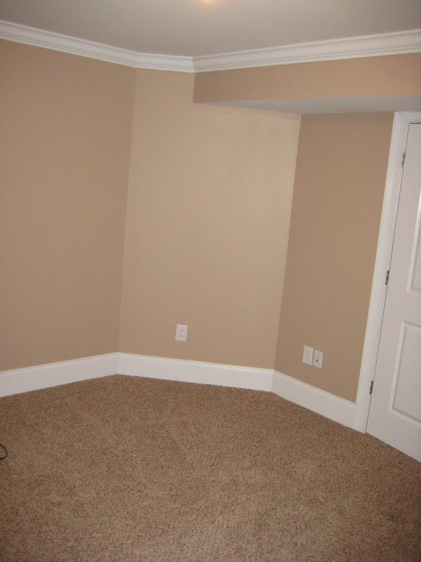

They're a little dusty, but we painted the stairwell to match the media room, including the trim. I was a little nervous about it, but it was the right call.

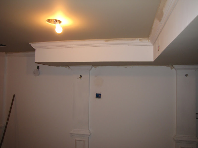

Looking through the window in the back wall into the kitchen area. Fridge will go on the right. Cabinets pending.

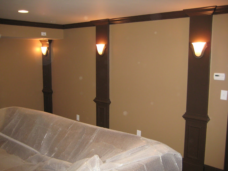

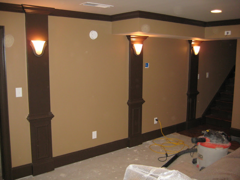

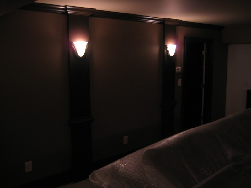

Finished columns. The sconces are on an IR controlled dimmer.
Back wall, under the window. We'll have counter coming through the window, and a 12" deep bar across the back wall with stools. We brought the laminate out from the kitchen 30" into the room for a "splash zone." kids can eat at the bar, food stays off the carpet... that's the idea anyways.

Really, really nice - love the look of those columns and the sconces, and that tapestry on the landing is perfect!!

Very nice job with the MDF columns and trim work. This is almost identical to what I have planned for my basement project starting this week and your setup will help me explain this to the contractors.
Quick question --how did you attach the MDF panels to the wall?
Curious, is the color of the pergo Potamic Hickory?
post #43 of 100
two ways to do the MDF. One of my contractors talked about just slapping up two layers of MDF for a 1.5" thick column. I didn't want to do that because I knew I would always see the seam, despite any putty or caulk. Plus, by making them 2" they are a little more prominent, especially with the trim.
The edge joints are beveled, I've got a large table saw and have it dialed in within 0.01 degrees, so getting a good tight 45 angle beveled joint was easy. May be harder to do with a portable jobsite deal. I don't know what your setup is.
To attach them to the wall, I used 1" thick pieces of some scrap maple I had lying around- let's call them brackets. any solid wood would work. Fortunately, each column had a stud somewhere behind it, so I cut the maple to 10 1/2" inches long and 3 inches wide (fits inside the back of the column) and attached two pieces per column to the studs, top and bottom. The top piece I actually attached to the top plate of the walls, with 3" wood screws. Then, I set the columns over the brackets, and predrilled and countersunk screws on the sides of the column (the skinny 2" wide part). By having the brackets at the top and bottom, the screws that I used to hang the columns are concealed by the baseboards and crown. I also set the columns off the concrete floor about 1" with some pressure treated scraps- you don't want that MDF absorbing moisture.
I hope that explains the process. I can diagram it out for you if it's not clear.
Spot on with the flooring. We looked at engineered wood and laminate, and the pergo potamic hickory 1)looked the best and had the most depth, even more than some of the real wood, 2) has a distressed look. we really wanted a 'handscraped' look but when you look at big pictures of many laminates it just looks fake, and handscraped engineered wood was a lot more. this has a distressed look and the texture lines up with the grain, which a lot of laminates have a generic texture that may or may not match the grain and 3) is almost identical in color to the floors upstairs, which helps to keep the space consistent with the rest of the house. Several people have mistaken it for real wood. I'm thrilled with how it looks. I swore previously that I'd never get near laminate, but now I'm a believer.

This is very helpful --thanks for taking the time to explain. I should be able to have my contractor build them as suggested --he has a full workshop where can fabricate offsite and assemble/install them in my basement. If you did have some simple diagrams that would certainly help me in making sure he performs the work correctly.
we were very surprised by the pergo potamic hickory as well. when I first started shopping a few months ago I never thought that a big box store stock pergo would be the best option. but after checking out engineered and other special order laminates my wife and i found that the potamic hickory looked the best, especially handling light reflection at home with some swatches we purchased first. interestingly enough, we found it was a fairly close match to the natural wood in the upper floors of our 1935 house --so much the same as your observation we found it provides a more natural flow.

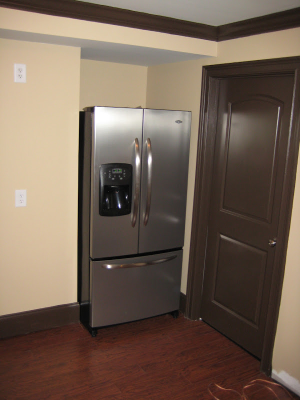

So we bought a fridge this week. I had started shopping for 'apartment' fridges (33" instead of 36") to fit the little nook we created when we put up the wall dividing the kitchenette area from a mechanical room. We didn't plan it, but turns out we created a perfect place for a fridge- down to the door placement, which effectively creates a 3" deeper wall right where the fridge handle needs room to open. Anyways, saw a fridge on clearance for a good bit less than any local dealers had it, so we jumped on it. We will put some 12" deep cabinets to the left of it, and above it, to give it more of a built in look. We have three rapidly growing boys (and maybe more down the road) so we figured instead of a little dorm fridge we'd go ahead and get a full size one.

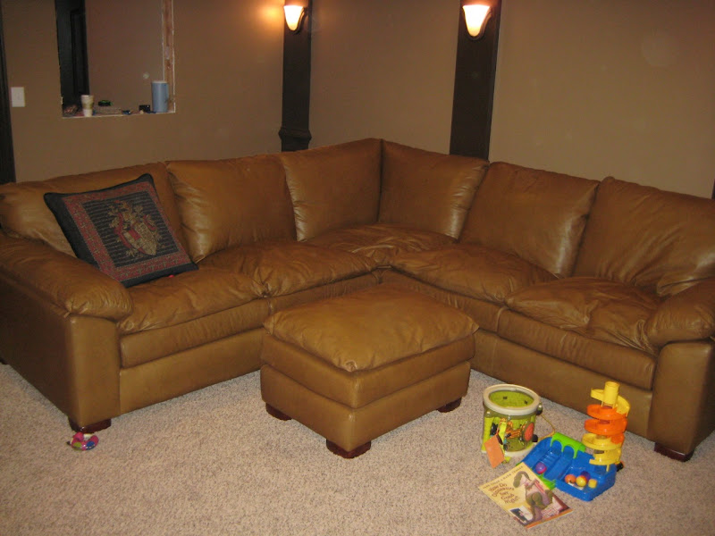

Here's a pic of the sectional and carpet. The sofa is 120x120 long. We got two ottomans in the deal as well- another item found on clearance at a significant discount. It's extra deep and extra comfy.

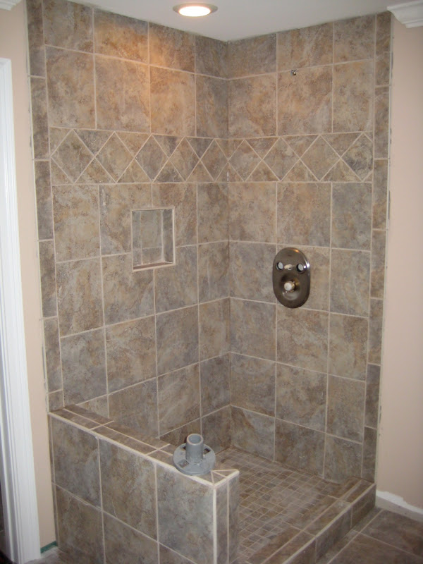

We spent enough money on the shower, I'll show you a pic. Glass enclosure pending
