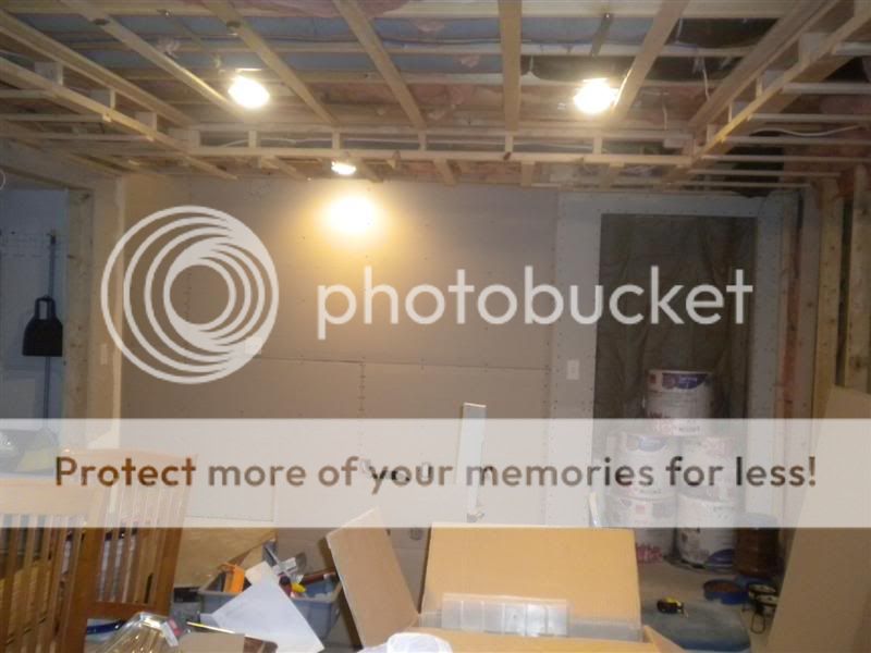

I've always wanted a room that was purposed for HT, inwall wiring etc. After years of wanting and a few of planning, I have finally started my build. This has been a slow process, I actually started Sept. 08 when I bought my first ten 2 x 4's.
Certainly not on the grand scale as many builds here but, a true DIY effort. I didn't have a lump sum budget and have been spending on average about $75/month on materials and tools. The theater is 12'-3" wide by 22' long with an 8 foot tray ceiling and 7" soffits. It will initially be a 7.2 surround set up but also wired for 9.2.
The room is finally reaching a point were it is worth showing. Here are some current pictures of the stairs and back wall.
I'm working my way around the room and have been struggling on a decision about were to place the larger of two subwoofers. It measures about 26" deep by 24" tall and 24" wide. I'm hoping to install it recessed in the front wall were the fireplace jog is. Here is an image of what I'm thinking. Im open to suggestions on the best way to do this.
The plan right now is to install additional lighting, finish the A/V and network wiring, HVAC and have the sheetrock completed by January 1, 2010

post #8 of 64
Here are some pictures of the progress.
Side wall going up
Insulation
Vapor barrier
Sheetrock
The front wall going through the same process with all the necessary wiring. I reframed the wall to accept the flush subwoofer. The subwoofer is sitting on pressure treated lumber feet and 2 x 4 frame. I'm using a anti-vibration matt under it and beside it that is typically used with industrial equipment. Im hoping this will keep the wall shaking to a minimum. I'm also placing 150 lbs of pool sand on top of the subwoofer to keep it from moving. For those interested, it is an 8 cu. ft. sealed box with a Maelstrom driver from Adire and Parts Express 250 watt amp.
Front wall before subwoofer pocket
With the subwoofer pocket framed and wires run You can see the extra 2x 8's I nailed in place for a plasma mount
The opening to the right of the subwoofer will be covered with the speaker grill and used for access to the sub and in-wall/thru-wall wiring. It also keeps me to code with the subwoofer power. The speaker grill will have a piece of foam insulation sized for the door.
Insulation
and Sheetrock
Here is a picture before the soffit lighting
and with eight 4" diam recessed lights to be on a dimmer.
Thats it for now. Next step is the HVAC over the next week and then finish the ceiling before Jan 1.
