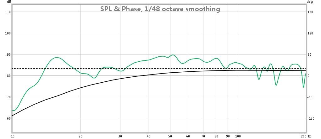

This is my response graph after sticking the sub in the corner, running multiple sweeps, and adjusting the level to fit. Doesn't look too bad to me... tongue.gif 50hz crossover, amp knob to left (gain around 11dB), receiver output to -6dB. Didn't put the EQ in but I might not need it here...
With listening I will obviously be relocating the amp to the closet due to the fan. Everything sounds good so far, but I might add a house curve. I'll have to listen for a while to know. It annoys me that I had to spend ages to get a decent response in my old room, then in this one just sticking the sub in the corner and adjusting the level without EQ gets that response. rolleyes.gif
It does seem to sound great though - just a bit of midbass work and I should be set.

I measured again with the same settings in a similar spot, but with the subwoofer amp off and the speaker HP left on.
Comparing the graphs, I can see that the sub is extending the response to the low teens (it is currently tuned to 19hz, actually). I might try different cross-over settings and such to see if I can smooth out that upper band (58hz, 86hz). I didn't post a 1/6th smoothing graph, but when I look at 1/6th smoothing I can see that the 50-140hz region is 4-5dB shy, which can definitely be heard. One thing I don't like about my AVR is that it removes the ability to EQ the 62hz region when you set the speakers to small, so I can't do anything about that unless I set them to large and have them run along with the subwoofer (THD below 40hz is an issue then), add the EQ into the system and add some output from the sub at the midbass (could sound "unnatural" or some other appropriate description), or increase the cross-over frequency to see if I can get more even response from the sub (...).
The speakers by themselves seem to be harsh. I have had others in the room to listen with me for extra opinions and we unanimously agree that the bass guitar is hard to hear, there's not much kick to the bass drum, and voices don't have enough body. I'm assuming that I need to bring up the sub 500hz range a few dB. From my observations, I gather that my room has the majority of its modal issues through that range. Room treatment (beyond the current amount) is not an option, so I'll just have to experiment with EQ and placement until I hit that magic combination... rolleyes.gif
Fun fun...
