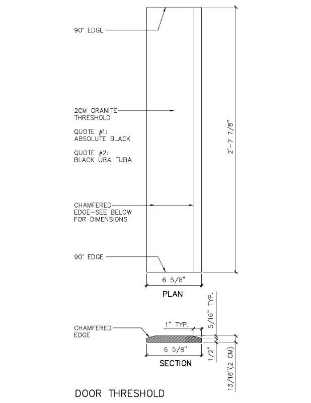

Why not go with a Zero International Model 564 threshhold instead of the granite? You will actually get a higher STC performance from your theater door. Here is a link: http://www.zerointernational.com/pdfmaker/pdfviewer.asp?referrer=search&page=0&part=564&instr=1&instrfile=27.pdf
Are you also planning on using the Model 367 automatic drop-down door seal? It is made to work perfectly with the threshhold, fyi. Here is a link to that: http://www.zerointernational.com/pdfmaker/pdfviewer.asp?referrer=&page=&part=367&instr=1&instrfile=27.pdf

Carpet is 5/16" and pad is 3/8", so about 11/16" total. The middle of the threshold will sit just proud of the carpet at 13/16" but the leading edge should sit just below. The 1/2" edge below the chamfer is based on the 5/16" carpet sitting on a 1/4" thick tack strip. This should put the surface of the carpet 1/16" above the leading edge, or essentially flush. Does that sound about right?
