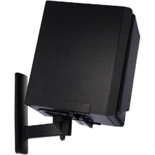

Mine are wall mounted with PinPoint AM-40 mounts:
My center is lying down, so I use a Samus component shelf:
My ports are really close to the wall. I have no problems.
