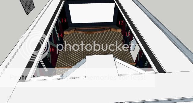

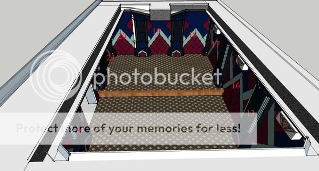

Well, for the last week I have been immersing myself in all things Sketch-up. I downloaded the free version, went thru the tutorials, played around a bit, and then got down to business of putting my thoughts down on pixels. All in all, not a bad program for the price. Though I am used to more sophisticated 3D modelers; but they come at a steep price I would much rather sink into the HT.
So here goes....
Picture of a wall column wrapped in the various GOM fabrics I've purchased...
Topside view of the finished HT with the HT chairs viewed front to back (ceiling layer removed)...
Same view, no chairs...
Close up of the wall panels and columns on one of the walls...
Bird's eye view back to front...
Bird perched on the soffit moulding with chairs...
A few disclaimers: We haven't picked out carpet yet. Used std. version in Sketch-up. Didn't waste time drawing the actual wall scounces but those are the correct pictures I pasted to a cube. Ceiling/soffit moulding also are not the versions pictured in my head. But it gives the general idea of mottled stonework I shooting for. Still moving forward with rune sewn fabric stretched over framework for the moulding. The chairs sizes are just an estimate.

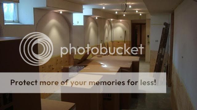

Time to test your imagination.....
For the last couple of weeks I've been going through my inventory of collectibles to determine where I am going to put each peice. What I've done is number pictures from previous posts. Under each is what I plan to put where. As you will see these will consume a lot of wall space.
The statues are from the Sideshow/Sideshow Weta collection. The swords from the United Cutlery collection. If interested you can go on those websites to see the actual thing if you are not familar with them.
In the Game Room area...
1 - Sword - Sting, Statues - Bilbo, Frodo, Sam, Merry, Pippin, Treebeard, Gollum, Smeagol
2 - Sword - Witchking, Eowyn , Statues - Morgul Lord, Eowyn, Gandalf on Shadowfax, Haradrim soldier
3 - Sword/Staff - Glamdring, Saruman Staff, Gandalf Staff, Statues - Gandalf the White, Saruman, Grima Wormtongue,
4 - Sword - Sting (musuem) w/scabbard, Andruil w/scabbard, Glamdring (museum) with white and blue scabbards
5 - Statue - Legolas and Gimli on Steed
6 - Statue - Aragorn on Steed
7 - nothing
8 - nothing
9A - Sword - Shards of Narsil, Adruil, Herugrim, Statues - King Elessar, King Theoden, King of the Dead, Argonath, Minas Tirith
9B - Sword - High Elven, Fighting Knives of Legolas, Hadafang, Statues - Legolas, Arwen, Elrond, Galadriel, High Elven Soldier
10 - Statue - Watcher in the Water
10 (on opposite side) - Statue - Gandalf the Grey (legendary)

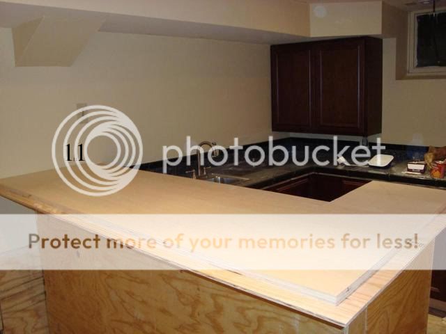

The bar top has now been finished. Here are a few pictures...
The actual color is more red than brown. It is made from maple veneered plywood and maple bar rail from Rockler finished off with three coats of Varathane Cabernet Gel Coat Stain and 4 coats of Helmsman Gloss Spar Ureathane.

The raised panel portion is similar. The left hand moulding on #54 is the raised panel moulding. It has a 1/2 rabbetted cut. This allows room for the 1/4" panel to be placed on the wall and the moulding to be placed on top of it. So it rests and is nailed to the frame and holds the raised panel against the wall.
Do not nail the raised panel to the wall or the moulding to the panel as the intent is for the panel to expand/contract with changing conditions over time.
I hope that answers your question. If not just reply back and I give some more detail. If needed I can post additional pictures if needed.
This isn't really that hard. Just time consuming if you want a professional look.
