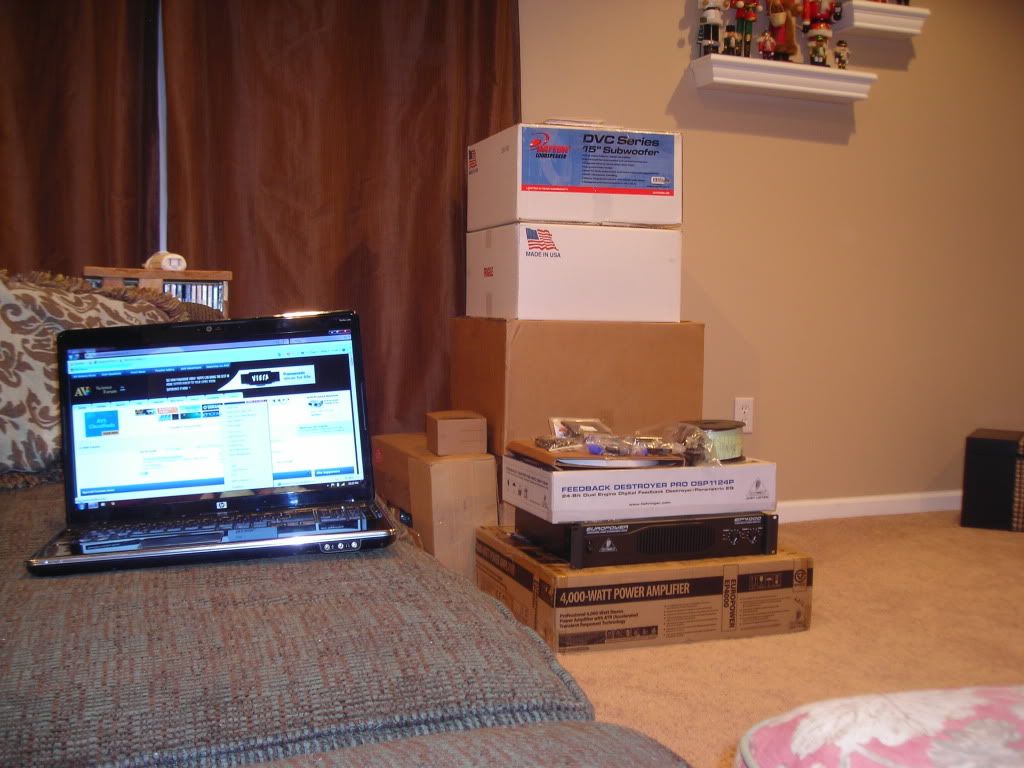

After my 2 week buying spree, I think I've collected all my parts.
I hope to get everything cut out this sunday, but won't be able to start assembly until the following weekend (Possibly Christmas Eve).

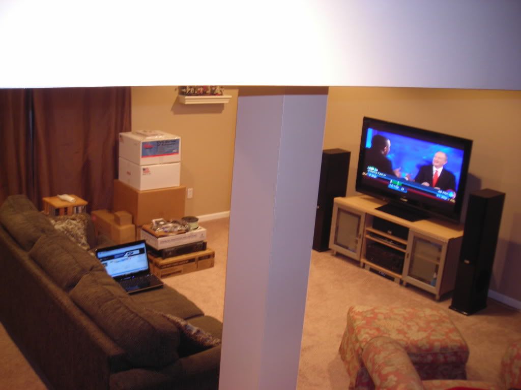

I know, my basement room is small but I'm getting ready for our new home (Hopefully this summer).

Where do you plan on putting them? One in each corner of the TV wall? Or stacking them in one corner?

I'm not sure.
What does everyone think?
post #4 of 393
I would say on either side of the tv in the corners allowing them to corner load would be nice. Im positive any placement you decide will rock that room and with two you should have alot flatter response. If these things sound half as good as lead on then your going over kill with two of these but thats awesome.

Just a side note, this EP4000 is one heavy dude. I was pretty shocked.

Since you only have one row of seats, I'd say put them in the front corners, but with the mouths facing inward, at 1/4 the room's dimension. The best alignment to cancel room modes would be that one or the horn mouths on the midpoints of the side walls.....make sure to make mirror-imaged cabs...
You will not be lacking in low end....Reference to 15Hz (if not lower) at very low distortion should be easy for you....the other speakers will now be your weakest link...not a bad situation to have, considering usually it's the low end that is the weakest link.

It uses a regular linear power supply not a switch-mode one, that's why. A high power linear PSU requires a BIG transformer.

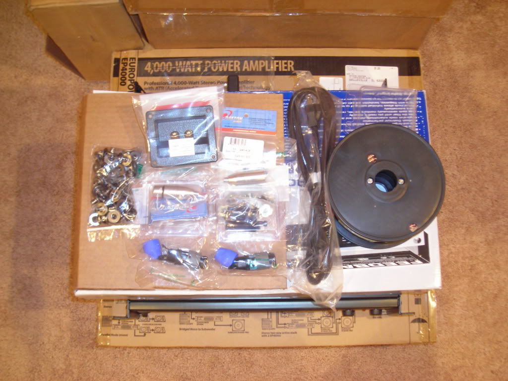

Can you post the exact speakon terminals you bought? Are those going to be flush mounted?
post #12 of 393
With the cup he has, I'm assuming the speakon ends are for plugging into the EP? On a side note, I'm in St. Louis, you'll have to let me hear this monster. I'm trying to talk to wife into a 36" version for our basement...Told her we could disguise it as a card/game table(and have it corner loaded).
