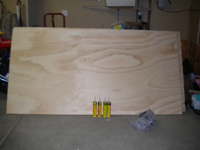

Well after almost no debate on my end i decided to build one of these suckers. I have the dayton dvc 15" and everything else needed on order from PE. I got the shipping email today so hopefully it wont take too long to get. Im cheap so for the time being ill just be using a dayton 240watt amp i already have to power this. I also went and bought some 1/2" arauco ply, pl premium, screws, and some new saw blades today. No luck today on getting started on the actual build due to a sick kid so she gets the attention today. So as far as pics to get this thing going i only have one of the wood but ill post it for now. This wood is thin so i know ill have to be extra careful when putting the screws in it so i dont stick em through the sides of it.[IMG][/IMG]
