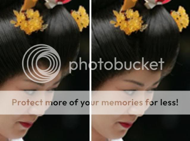

Originally Posted by Highjinx View Post
Stair stepping is not caused by optical scaling/zooming.......sounds like you are refering to nearest neighbour digital scaling.
Much the same thing since you're enlarging the source pixel. Bicubic or Gaussion give much better results. If you assume NN scaling which results in 4 identical pixels to the original source pixel, what's the difference between that and a 4 x optically enlarged pixel?
Spreading existing detail over more pixels does not give one more detail, in fact there is a softening of the image. As demonstrated by AmirM, scaling a 2k image to 4k.

Which image of these two do you prefer:
Both are from a smaller original and one uses NN which in this case is the same as zooming, and the other uses bicubic scaling IIRC. Image original supplied by AmirM btw. The left one may be more accurate to the original, but has distortion in the form of jaggies. do you prefer the one on the left?
