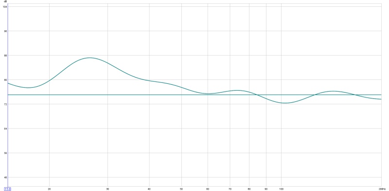

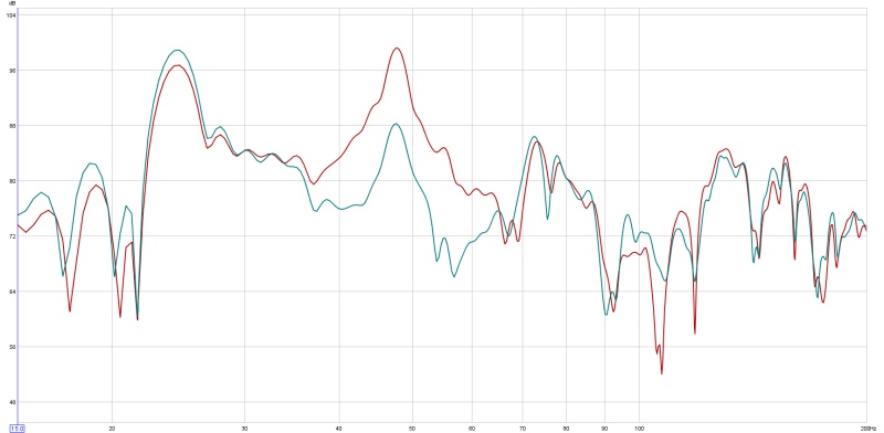

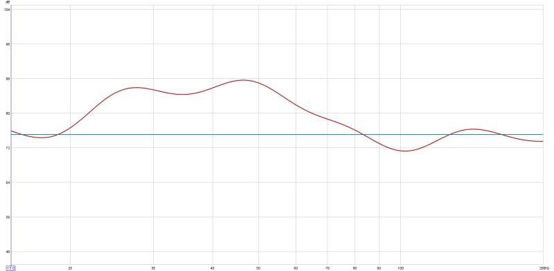

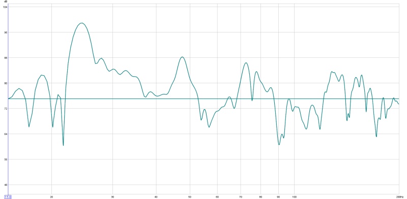

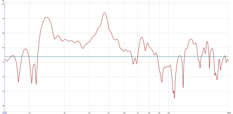

Changed them to log scale... posting all graphs here.
Originally Posted by DonH50 View Post
No worries, I was just curious. You'd need a room dimension around 19' to cause a response at 30 Hz, but that could include other rooms if it's open to them. Bass traps could help, but you'll need a good one to reach that low (an Auralex LENRD probably wouldn't do it).
yes my room is very large... 25 x 28 or so and has an opening going to a hallway.
In room response with front speaker + sub @ 80hz xover unsmoothed.
In room response with front speaker + sub @ 80hz xover smoothed.
In room response with front speaker + sub @ 80hz xover unsmoothed w/ PEQ filter applied.
In room response with front speaker + sub @ 80hz xover smoothed w/ PEQ filter applied.
In room response with front speaker + sub @ 80hz xover unsmoothed. Before peq and after peq.

Porksoda.... Ah, that looks much better... more like what I'm used to seeing for in-room response graphs. Do you have one with just the sub alone? Is your room acoustically treated in any way? Have you tried other X-Os? Also if you could post the corresponding waterfalls for each graph that would go a long ways in describing your room's acoustical environment since the Rythmiks have so little "overhang". And finally does your AVR have Audyssey Multi-EQ capabilities?

I think i will do one with the sub alone... ill unplug the main speaker and do one... i will post it later today.
My room is very limited in what i can do with it... it has zero treatments.. the finish on the sub is so good that i was allowed to pull it out of a hidden corner and put it out in the open where it sounds the best.
I will post the corresponding waterfalls later as well.
I tried eq at different spots and so close to a hundred or so graphs... i found 80hz to be the best for me... if i did anything at below 80 there were some unwanted peaks from my speakers.
No my receiver has no correction software.
So far the only correction i can do is on the sub itself for single band.. which i have applied quiet successfully to reduce a peak.
I have gotten so "attached" to rew that i set my levels with it as well and then i confirmed and they were bang on.
