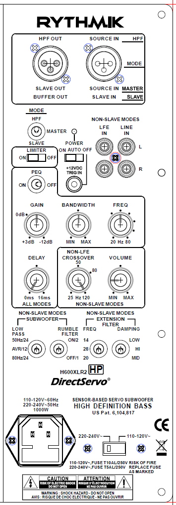

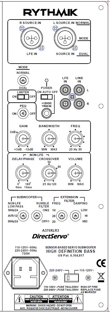

There has been a couple of questions.
1) XLR2 and 3 layout are http://www.rythmikaudio.com/download/XLR2.jpg and http://www.rythmikaudio.com/download/XLR3.jpg PEQ controls are separated for master and slave for the same reason that delay control is separated for master and slave.
2) F12 feet thread is M6. The rubber feet version (for hard floor) is almost ready.
3) I am getting pull in all direction. So my email reply has been a bit slow lately (after the camping trip). In addition, I will be visiting suppliers between 3/24 to 3/30. After that, I don't have any travel plan for a while.
4) @Iain, I am interested in hearing your feedback about coloration from limiter. If the coloration exists and is consistent even when it is at low/moderate level, then it is indeed the coloration of limiter. If it only occurs at loud passage, then it is a result of limiter being triggered.
