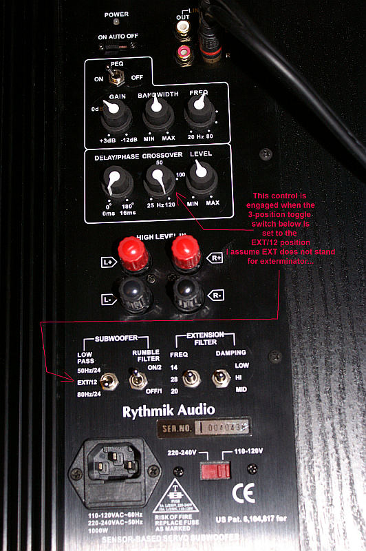

Do Rythmik products have their logo on them because I just don't see a logo on their subwoofers. I am considering buying the FV15HP and was trying to see where they put their logo on that FV15HP.
post #6324 of 9656
If I am not mistaken I believe on my FV12 there is a logo on the amplifier, but none elsewhere.
post #6325 of 9656
Ah, I found this image showing the back of the FV15HP with a logo:
http://www.audioholics.com/reviews/s...iew_fullscreen
