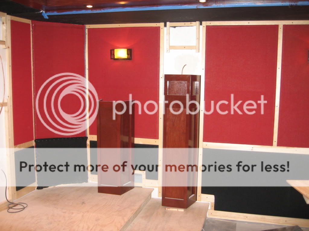

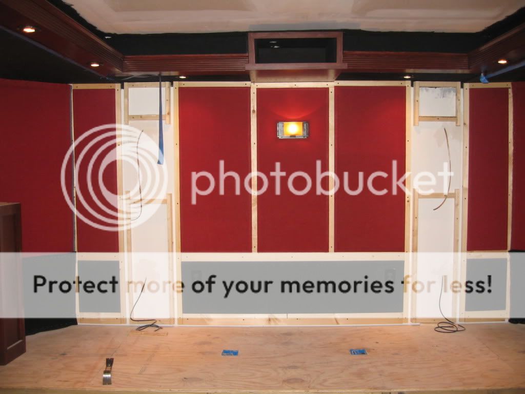

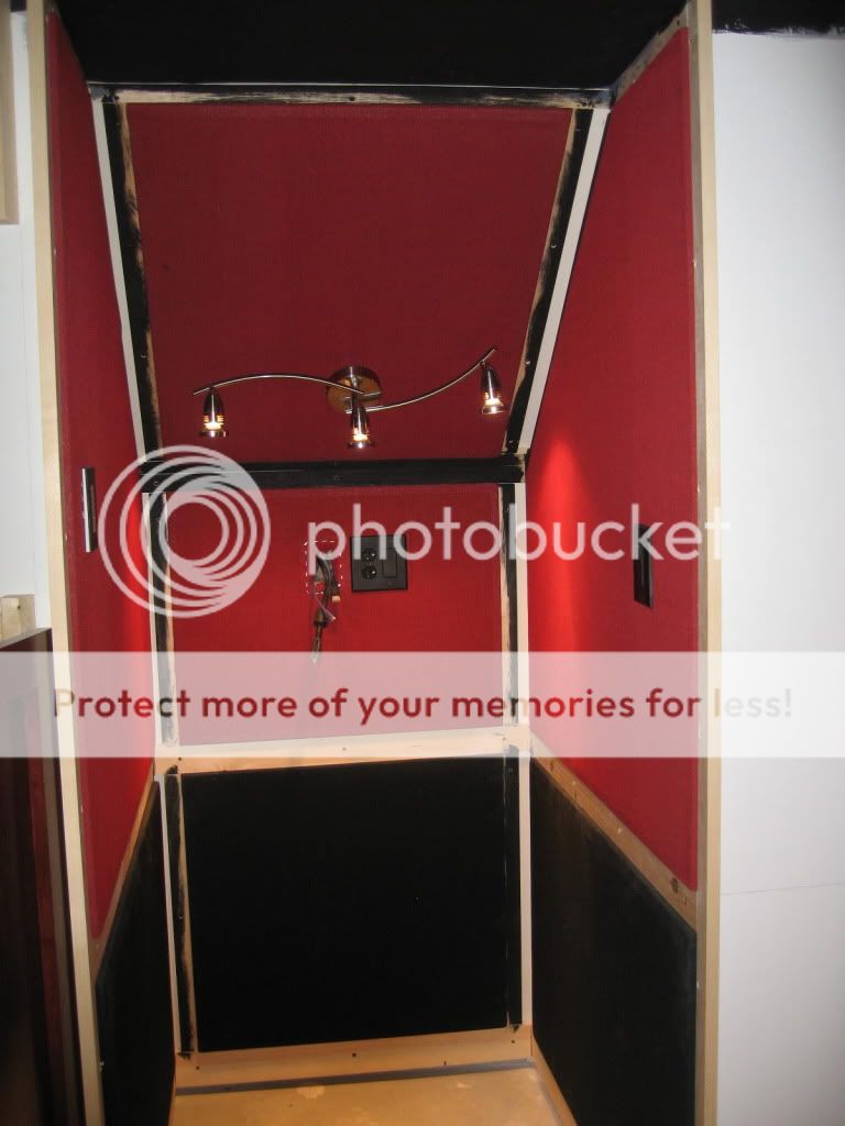

Slow, but nevertheless, some progress, fabric frames are finally done. I opted black fabric for the bottom portion of the wall:
and this is the cave space under the stair case:
All lighting fixtures have been installed in the theater room except step lights.
Now, trims, do you prefer installing trim before carpet or after carpet or it doesn't matter?
How about screen false wall? Before carpet or after carpet? The reason I am asking is because the space behind false wall on stage, if carpet is installed first, then false wall will be just sit on top of carpet, otherwise, it needs a small piece of carpet installed behind false wall separately.

If you are talking trim carpentry, such as baseboard, etc. It is typically installed before the carpet but you must suspend the base molding 3/8" above the floor. You can easily do this just by setting some scrap 3/8" blocking on the floor to space your moulding at an even height around your room. Plus you can create the last of the sawdust, stain/paint and caulk before the carpet goes in.
Second, I would never frame a wall on top of a carpet, so build your walls first, even if the carpet must be trimmed around the wall.

Nice call on the black - really makes things nicer than the blue in my opinion. Keep up the good work!

Thanks TMcG for your advices, I am thinking doing the trim pieces after installing carpet only because the weather is still cold and I don't want do the staining/painting the trim piece inside, last time I did my columns, the smell was horrible, especially when the gas heater was running, sucking all the molecules and burned them, creating a such strong smell that I had to open all the windows to flush them out. But it looks like this year it won't get any colder, usually day temperature is around mid 40s to low 50s, I think I can stain/paint in garage.
OK, I will probably build false wall first.

I got a nasty cold in past few days so not much get done, but I do get screen false wall installed today, Quick question about screen aspect ratio, it should be 1:2.35, 1:2.37 or 1:2.4?
