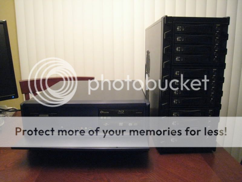

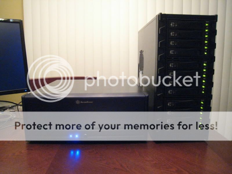

Finished Product
Front panel open

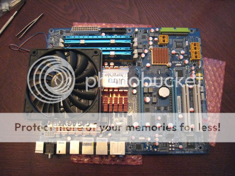

HSF Installation - One word...painful. Had to remove the heatsinks from the motherboard first to make enough room for the Scythe mounting brackets. Sausage fingers don't help the situation any. The fan hangs over the first DIMM slot, so changing out the RAM would require taking the whole thing apart again.

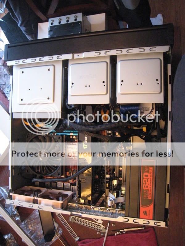

HTPC Case finished - Needless to say, it's a tight fit with that GPU. Also, the 24 pin bracket on the motherboard for the PSU connection is right underneath the optical drive cage, which is another tight squeeze.

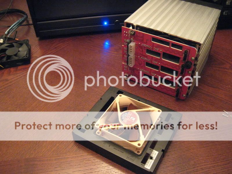

Hot swap bay fan replacement - Definitely not plug-n-play

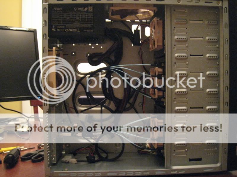

DAS Enclosure finished

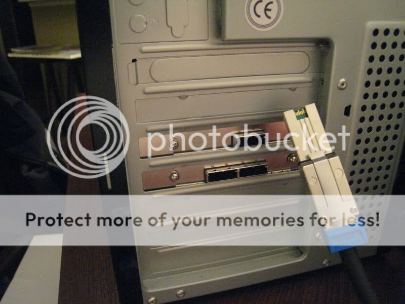

Rear of DAS Enclosure - Just a close-up of the 3 mini-SAS ports and cable head.
All in all, I've very pleased with the setup. With all the stock fans replaced, both cases together make very little mechanical noise at all. The only sound is a faint "swishing" of air movement, and that's from the DAS enclosure more than the HTPC case. Processor and GPU temps are where they should be, and the DAS enclosure is keeping my 2 TB RE4-GP drives at a cool 29 degrees C.
My only complaint with the Noctua replacement fans is speed control. Each fan, regardless of size, comes with an attachment that reduces the voltage depending on if you want more air flow or less noise. This makes changing settings a real pain if you plan to tweak, but not that big of a deal. A 3 setting switch would be a better solution, especially for the price.
