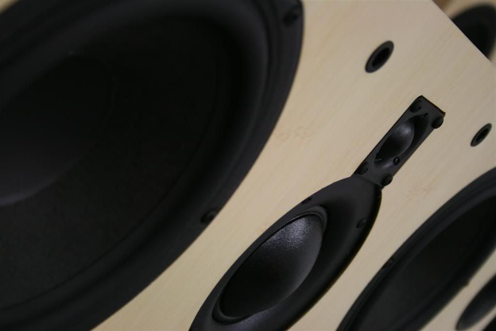

Elemental Designs has a new line up of terrific looking speakers. The line up includes a 4 foot tall tower, a 65 pound center channel and a nice looking high end monitor.
Several wood veneers are offered, and these look like serious contenders.
The center:
The monitor:
The link to the announcement:
Can you picture these with an A7-900? NICE !!

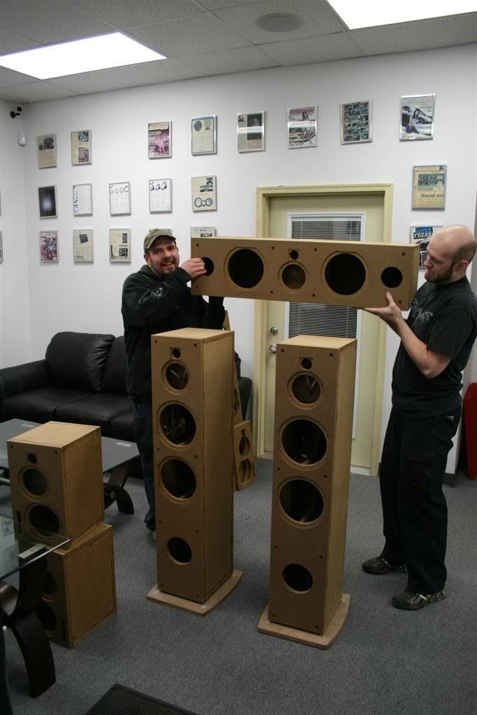

Here are a few pictures of everything so far. (Sorry for the different sizes)
The cut components are on the left.
Matt and Brett holding the assembled cabinets

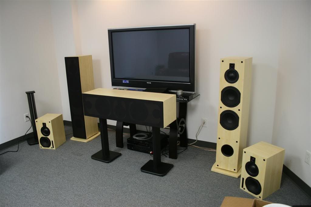

The final products
Cool pic of the center that eD took

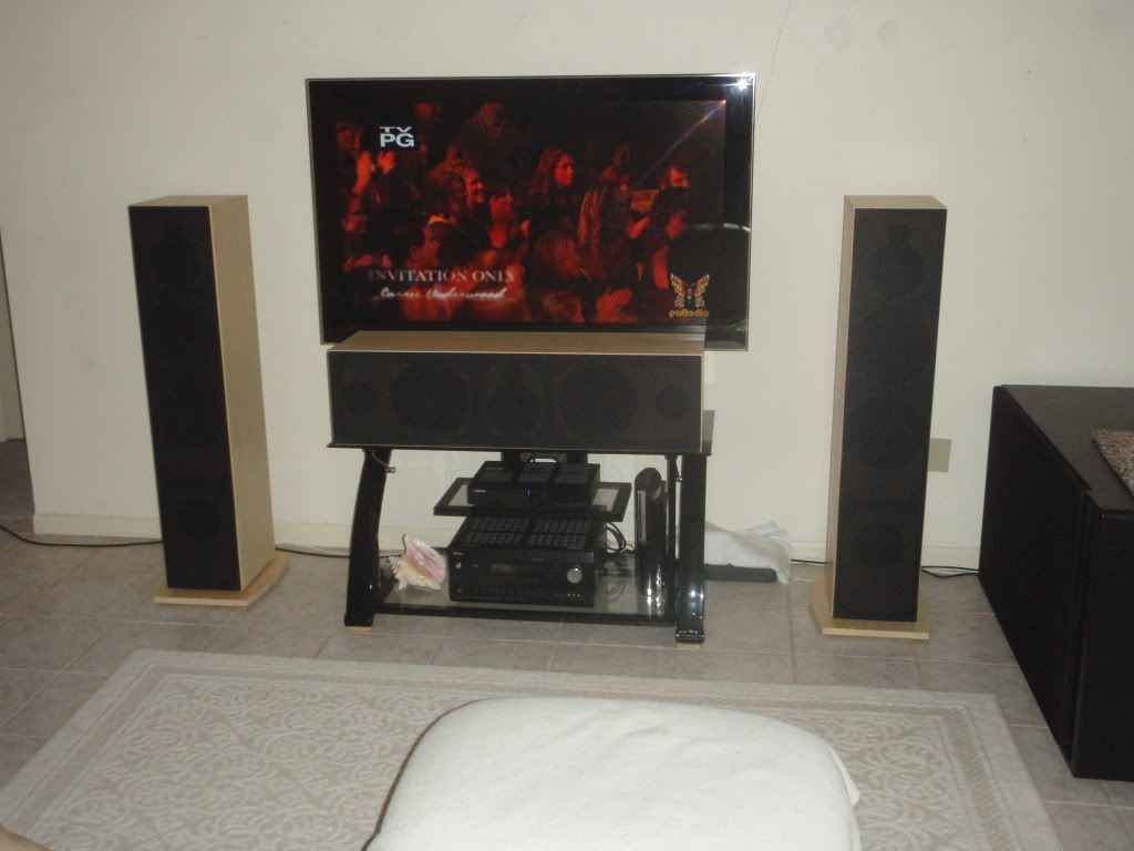

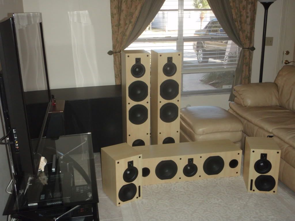

Everything in the LR, waiting for me to put together. You can see the A7-900 there too. :beer:
The towers and the center. The center is HUGE. Its a little overwhelming. (I may need to get a new entertainment center, but that's another job for another time.)
Adding the cover to the center softens it quite a bit.
With covers
