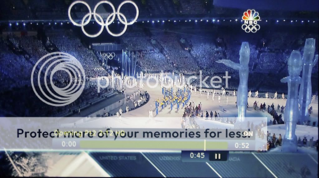

Opening Olymipics. Note the skin tones and overall color.Great! This is a still of the recorded HD which has lots of artifacts if you zoom in so take that under consideration. The original HD was spectacular.

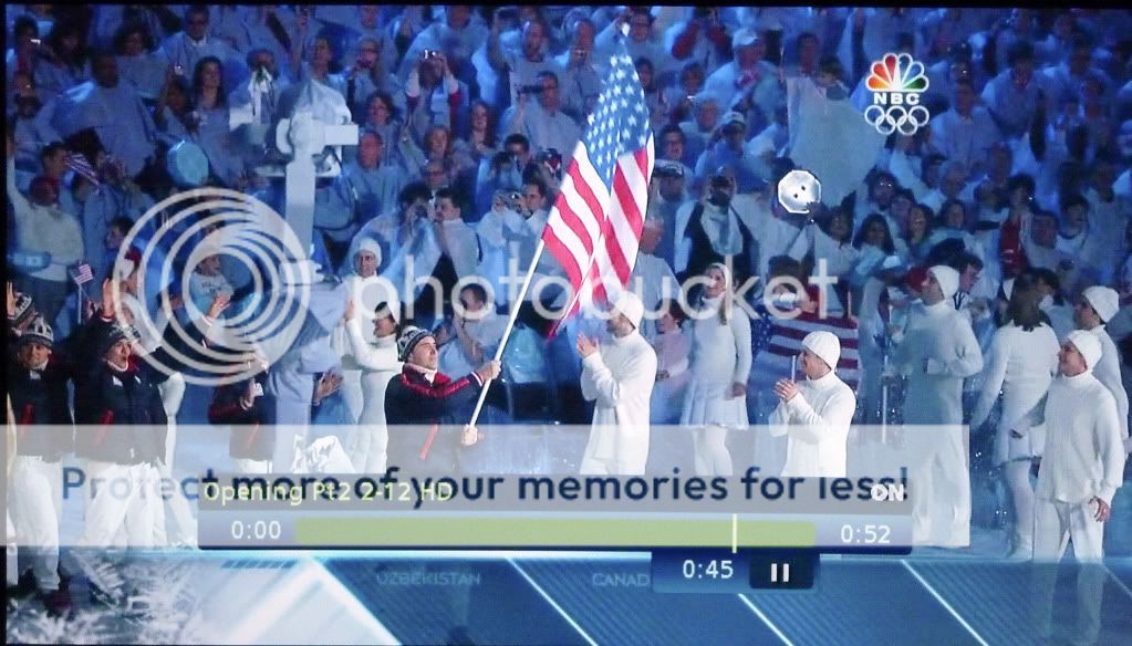

Just before the US walked in. Note the overall blue from the overhead lights and white ice underneath.
Yay, US team! Nice white uniforms in the background. Good flag colors. Nice contrast.

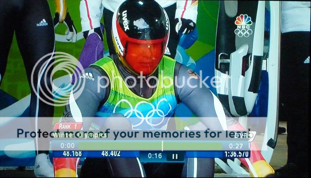

A luger getting ready. Note the black helmet--lots of different colors. Yes, he's wearing a red face mask.

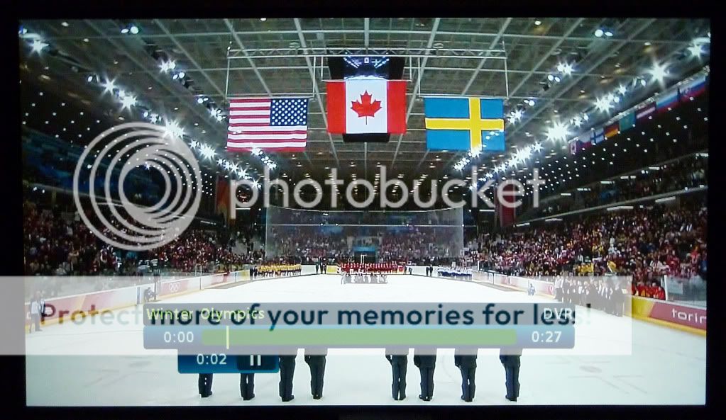

Inside the arena. Note this shows the velvetine border around the edge. Done with 2" velvetine sticky tape.

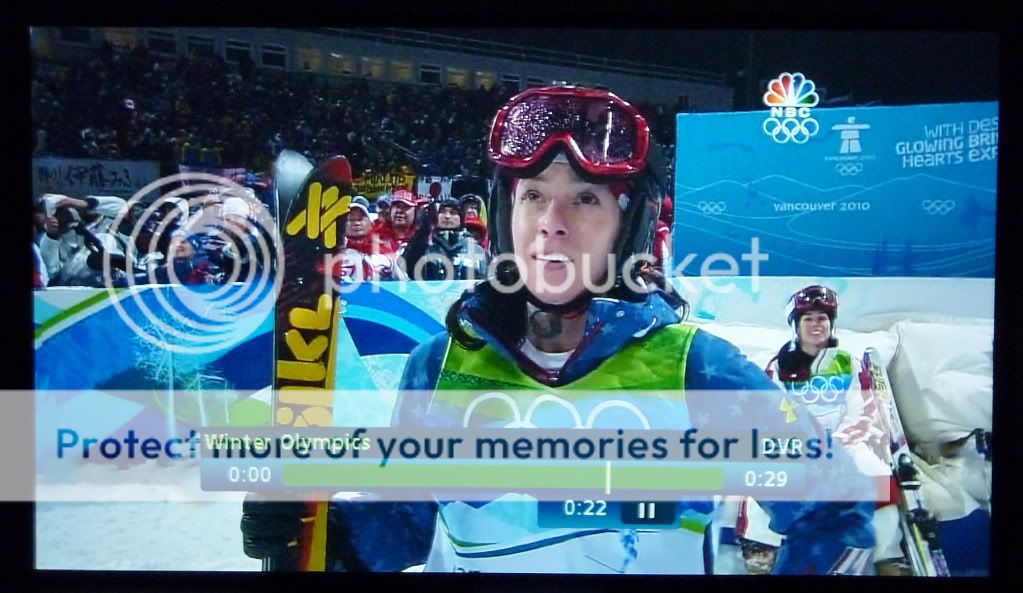

US takes women's moguls!! Again I went for the colors. You can only imagine what it's like on this big screen to watch the action. Absolutely AAAA-mazing!
