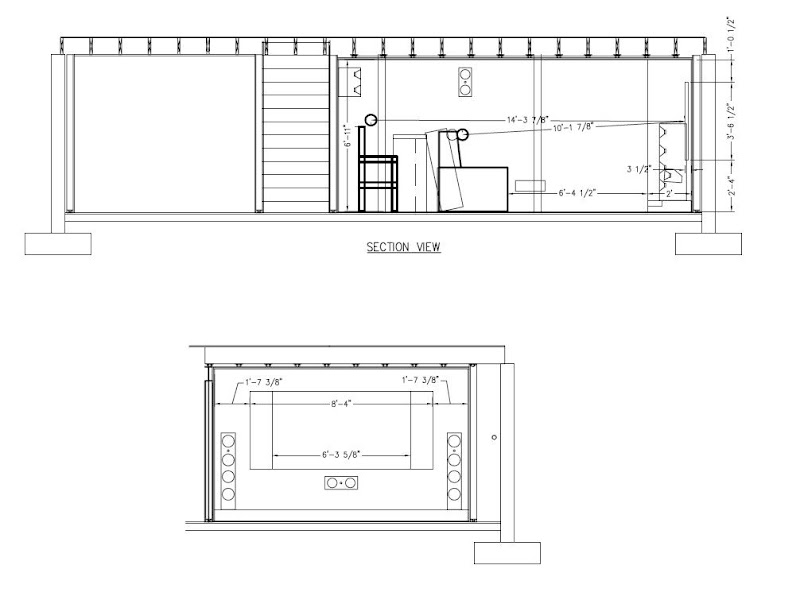

Started a layout in CAD:

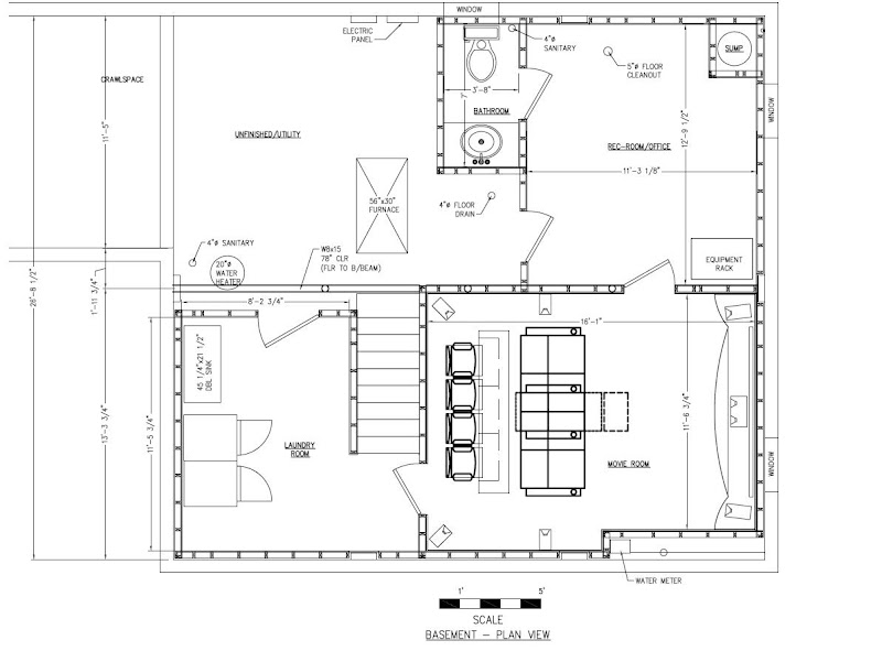

I've been tweaking the layout a little.
Was thinking about putting the equipment rack under the stairs, but I'm wondering if that will prove to be trouble by punching a big sound hole in the room right by the open stairs.
I would like to have access to the equipment from inside the room to load discs and what not.
Any thoughts?

Updated room layout with a couple of section views.
I'm trying to brainstorm a few items now.

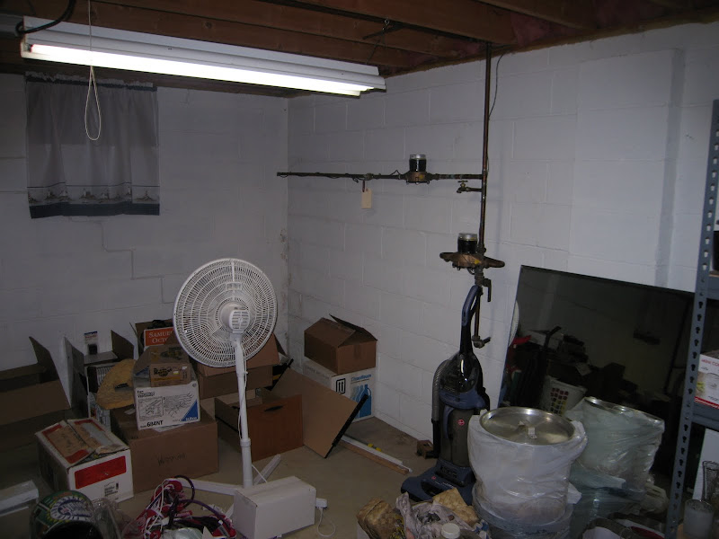

How can I create an access panel to the water meter, and still attempt to retain soundproofing when the access is closed?
I've also been combing people's builds looking at their HVAC plans.

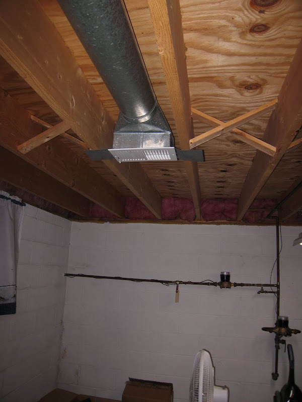

The room upstairs has a supply and return that runs between the joists. By installing the theater ceilings with clips and channel, will that effectively block the sound from running through the duct? I can look into switching it out to acoustic insulated duct, or surrounding it with insulation.
The other concern is heating/cooling inside the theater. There is currently a ceiling supply that runs between the joists. I don't want to install soffits in the room due to my low ceiling height, so I'm contemplating using the joist space to run the HVAC. I'm hoping that I can build a backing box or something to that effect that will shelter the upstairs from the noise.

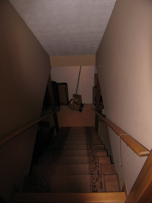

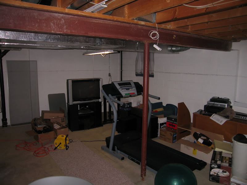

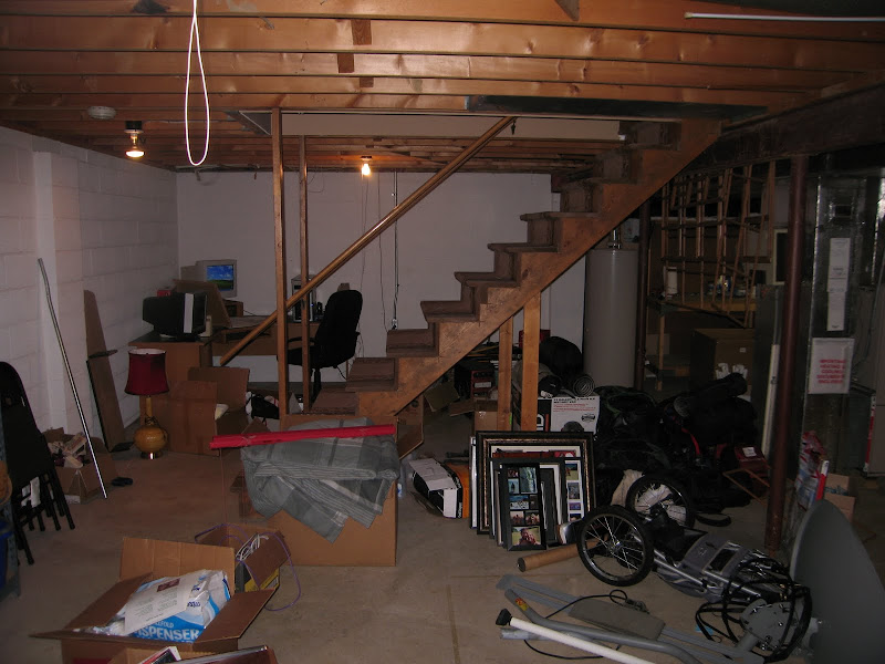

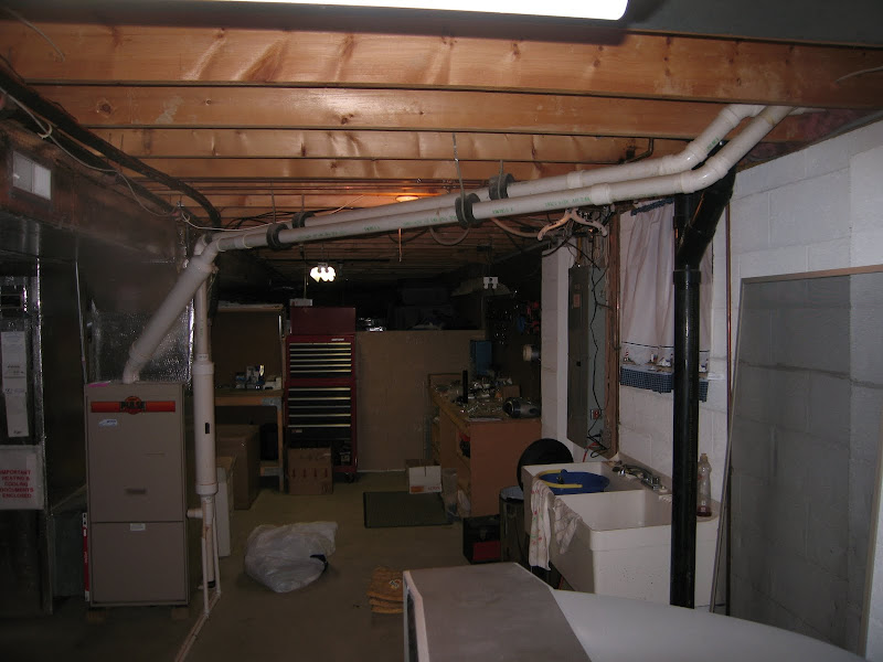

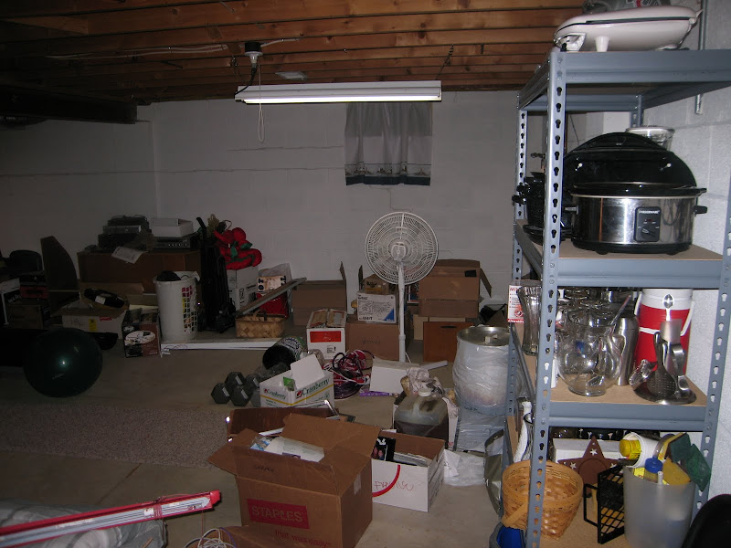

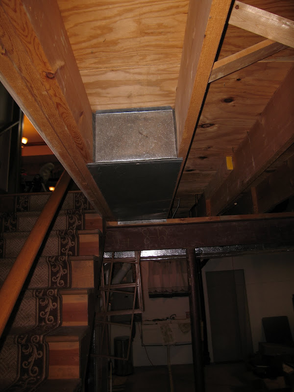

Got some pictures taken of the basement. Excuse my mess.
Down the stairs:
East of Stairs, looking at where the screen will go:
Water Meter and Irrigation Shut-off on South Wall:
Beam and Pole Provide North Wall for Theater:
View from Screen towards West:
North Half of Basement (looking West):

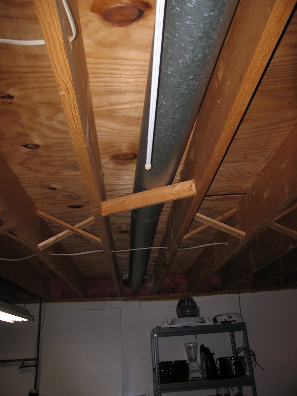

HVAC Supply for Living Room Above Theater:
HVAC Supply in Theater:
Air Return from Living Room above:

A few comments:
1. The back row of bar stools seems pretty close to the back wall. How much room will you have behind a stool? They also seem pretty close together. Would someone in the middle be able to get out?
2. The rear speakers seem too far apart. If you consider in-walls and play with the door location a bit, you could probably get those in a more ideal location on the back wall instead of in the corners.
3. Have you considered in-walls for the side surrounds? The quickest way to the bathroom from the back row would be along the left wall but that side speaker may get knocked around, at least by us taller folks.
4. I think where you put the equipment rack should work. It's close but keeps everything out of the room.
I will let the soundproof/hvac experts chime in on your other concerns. Good luck & keep us posted!!

Welcome to the madness. Take a look at my solution for the ductwork here. Just surround with insulation and MDF. You risk impacting your upstairs airflow if you replace with flex.
Also, take a look at Harrod's build, - he did a great job on a damping box for his HVAC to the HT.

A few comments:
Thanks for looking at my plans. I just used a basic cad block for the stools. I put the front of the bar 48in from the back wall. If the bar is 18in deep, that leaves 30in for bar stool and path. Might be a little tight to squeeze by. Maybe I can cheat it up another 6in or so.
I was checking through the threads looking for someone who did some in-walls, because I like the idea of hidden speakers. Seems most hide them in column treatments. And I am one of those tall people, so I'm sure I would curse every time I walked by and banged my head. It took me almost a year of banging my head to raise our kitchen table light. Would building an MDF Backing Box provide adequate sound isolation due to the speaker being in the air cavity of the wall?
Thanks for the links. Did you line your MDF with anything on the inside? Are Larry and Moe going to be permanent fixtures in your final treatment?
post #11 of 14
For the upstairs HVAC feeds, I insulated before MDF, but for the returns, I just used MDF. Could have used ductliner, but opted not to - MDF is much easier to keep cleaned out. My HT walls/joists are completely isolated from the upstairs joists. I will add insulation on the bottom sections before drywalling.

make sure that reducer you have your furnace is OK for the furnace size. A similar setup was on my furnace and it was wrong, had to be replaced with the full size of the outlet for the whole run.
