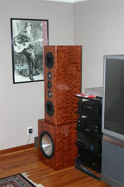

SEALED STATEMENTS

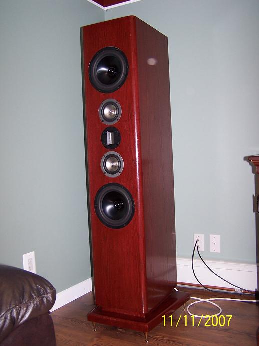

PORTED STATEMENTS

The finish on those sealed are outstanding!

Originally Posted by LJwelr View Post
SEALED STATEMENTS
Just to prevent any possible comfusion - that is a seal Statement on top of a seperate subwoofer.
