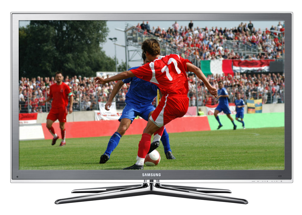

Was the C8000 silver or black. Don't think the 8000 is out yet
post #24 of 6288
I really didn't think it was an 8000 either, but it was NOT silver. It had a steel edge surrounding the black bezel, and it didn't have the ugly bird feet. It had a flat stand and a very nice steel (and somewhat heavy) remote.
Definitely is Silver - Brushed Stainless Look
