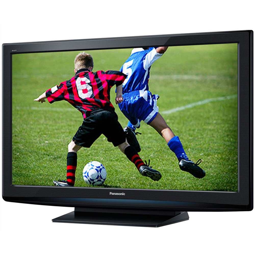

So I noticed Amazon has this picture displayed as the TC-P58S2.
http://ecx.images-amazon.com/images/...L._AA1000_.jpg
However when I saw the TV in stores @ Best Buy it didn't look like that at all...
http://images.bestbuy.com/BestBuy_US...9904681_ra.jpg
though I did see a smaller TV that had the same design. Did Amazon just screw up? I'm guessing the TV doesn't have the blue at the bottom and all the tiny holes around the bezel?
Anyway the TV should be here on Tuesday... I ordered it for a friend who I was helping TV shop. Like always Best Buy customer service was awful... when we first went in one guy in the TV department asked if we needed help and I asked him if I could see the remote to the TV and he just ignored me... clearly showing he was only saying what he was told to be said and not actually trying to help anyone... at least not us. I had to ask about 3-4 different times before I found someone who could actually help me. Glad I decided to sign up for an Amazon store card... saved him at least $150 and a convienced him to invest in a decent surround system all for under $1,800 with the cables. He then went out and spent $500 on curtins so there wouldn't be awful glare on the TV (since he went with the 58" that doesn't have the anti-glare filter on the screen). You don't know how hard it was to convience him to save $800 on this TV as opposed to a smaller LED LCD. He even admitted that the Panny looked just as good if not better, but didn't decide until one of our friends showed up and said the same thing, followed by the final BB employee that also agreed. Stop placedo effect going around in the LCD camp these days.
