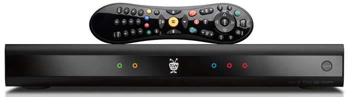

The TiVo Premiere is the company's next-generation HDTV DVR for over-the-air, cable, and Verizon FiOS. It launched in 320GB (46 HD hours) and 1TB (156 HD hours) configurations for $299 and $499 at Best Buy on March 28, and is now shipping from TiVo.com and Amazon.com. Existing TiVo owners with a monthly or yearly subscription receive a 20% discount on the Premiere at TiVo.com, with new units priced at $239 and $399.
The Premiere is based on the new "Series4" hardware platform with a faster dual-core processor, twice the memory, and improved I/O. The added processing power is used to support a new high-definition interface with a video window, much faster network transfers, and robust video playback with full 1080p output. Newer technology cuts power consumption by 35-40% for ENERGY STAR compliance.
New, all-black enclosure is roughly 3" shallower and 1" shorter than the TiVo HD. Click for high-resolution version.

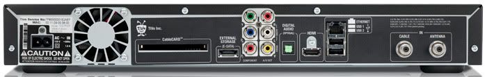

For digital cable, one CableCard (M-CARD) from the cable company is required to support both tuners. A CableCard is a form of access card; it plugs into the CableCard slot and authorizes subscribed channels.
The box has HDMI 1.3, component, and composite (RCA) video connections; it will output audio over HDMI, but also has analog stereo and optical (S/PDIF). Output modes are enhanced with the ability to selectively enable or disable every resolution from 480i to 1080p. All HD and SD outputs are active simultaneously, and the box downconverts HD channels to SD through composite for older televisions.

  12. How does the TiVo Premiere support multiple tuners with a single CableCard slot?
    In the TiVo Premiere, one multi-stream CableCard (abbreviated M-CARD) supports both tuners. Older single-stream CableCards (abbreviated S-CARDS) are not supported and will not work.
    About two years ago, Motorola and Scientific Atlanta (now Cisco) halted production of the older cards and began manufacturing multi-stream cards exclusively. These M-CARDs -- pictured here-- are now widely available from cable companies.
    A Series3 owner upgrading to the Premiere would swap out their older cards for one M-CARD.
  13. Does the TiVo Premiere support the existing SDV tuning adapters used by some cable companies?
    Yes.
  14. What external drives are supported?
    The TiVo Premiere only supports the Western Digital My DVR Expander (eSATA), available in a 1TB version for $129 from Amazon.com, Best Buy, and Newegg. This adds 145-150 HD hours to the Premiere.
  15. Will the internal hard drive be upgradable like past TiVos?
    End-user internal drive upgrades are not possible with existing tools. DIY tools such as WinMFS and MFSLive enable capacity on larger replacement drives by creating a new partition with the extra space. Prior TiVos recognized the new partition and used it to store recorded programs. The Premiere does not, so new methods must be found to utilize the added capacity on a replacement drive.
    Weaknees and DVRUpgrade discovered such a method, and both offer pre-upgraded Premiere DVRs with 2TB (317 HD hours) capacity, as well as pre-prepared 2TB drive replacements. Weaknees also sells an internal plus external drive configuration with 4TB (639 HD hours). Both opted not to publicly disclose the new method or tools for competitive reasons, so DIY enthusiasts must wait for the appropriate method and tools to find their way into the public domain.
    For now, Western Digital’s My DVR Expander (1TB eSATA) is the only option to increase capacity, outside of pre-prepared drives sold by DVRUpgrade, Weaknees, and some ebay sellers.
