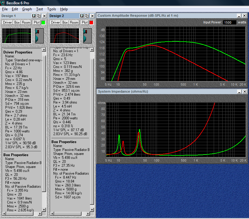

nith,
Just a few questions for you.
Are you thinking of having AE make special cabinets to hold the TC Sounds drivers or do these drivers drop in John's cabinets?
Have you ran any of these combinations through either Winisd or Unibox to see how they model?
Also, I would really suggest looking for a different amp besides the XTi1000. Those are not going to do those drivers justice in my opinion.
James

Originally Posted by nith View Post
Which one of the options below is better and why? And if any of these options were to be assembled, how do they compare to ULS-15, SVS Ultra, Rythmik, and of course the Submersive?
Option #1:
x1 P1512 cabinet $499.00 ea (Intro. price)
x1 TC Sounds LMS-R 15" DVC Subwoofer $539.00 ea.
x2 TC Sounds VMP 18" Passive Radiator $269.10 ea.
x1 Crown XTi 1000 $499 ea.
Total: $2075.20
Option #2:
x2 TC Sounds LMS-R 15" DVC Subwoofer $539.00 ea.
x2 Crown XTi 1000 $499 ea.
Total: $2575
Option #3:
1x P1024 cabinet $429 ea. (intro. price)
2x Morel Ultimate UW 1058 10" $394.40 ea.
4x TC Sounds VMP 12" Passive Radiator $179.10 ea.
Total: $2932.20
I guess my first question would be why you would be looking at using the TC woofers and Morel instead of the woofers we designed the kits around. Quite simply you will get significantly less performance for your money spent. We designed the kits not only to look good but also to take advantage of the 23mm Xmax of the drivers with a reasonable amount of power. Either 1000W plate amps or a 1200-1500W channel of a pro audio amplifier will get you near the full 23mm Xmax of the drivers which will give you some very good levels. We also designed the drivers to be efficient across the board from the high motor strength(nearly identical to the LMS-R at BL^2/Re of 114) to the high efficiency(3db more than the LMS-R) at the upper regions. The AV15H and PR18's in theory are going to give you 90% of the output of the LMS-R and VMP's. This is at less than half the cost for the drivers. They'll also require MUCH less power to get the same levels. They are a much more practical option, as getting that extra 10% requires significant increase in power. In reality getting the same levels with the LMS-R requires significantly more power. In addition to all of that, the AV15H has less than 1/10 the inductance so the upper bass response will be MUCH lower distortion as well. I could have designed a driver with more than 23mm Xmax. However in most cases it is not practical from a cost standpoint or power standpoint.
The PR's are in a similar situation. The cost is over 2x, for no more performance. Actually the extremely stiff suspension of the VMP's makes them much less effective. For a passive radiator to work properly it needs to have soft suspension. A passive radiator is a direct equivalent to a port. It is a mechanical piston that moves back and forth much like the air in a port moves back and forth. The air does not have a suspension though and the PR's do. In order to have the closest approximation without losses, the softer the compliance, the better. The VMP's have very stiff suspension. This means you will have much higher losses around tuning, but also need much higher mass to reach the same tuning. In the case of the P1512 cabinet you need nearly double, 5000 grams instead of 2500 to get tuning around 16hz. Here is a graph of the two options with 1500W applied which gets the AV15H to it's excursion limits at the peak above tuning. Red is the LMS-R and the green is the AV15H.
Overall the extra excursion of the LMS-R can give you a total of about 1.5dB more output overall at max excursion. However it isn't all that practical to achieve that extra output. You'll need 2x the power(3000W) at 20hz to even equal the same level as the AV15H and you'd need 3x the power(4500W) to get that 1.5dB extra out of the system. As you are applying that much power you have more thermal losses and still won't reach those levels in a real world application. However for even LESS money you could build the P1524 kit with the dual AV15's and 4 18" PR's. You would have 4.5dB more output capability on the low end and you'd have about 9db more efficiency in the upper bass regions.
I don't like to get into comparisons with retail products too much, especially the submersive since I work with Mark on a daily basis. In reality though you are comparing retail subwoofers to a kit that does need some work to be done. In terms of output though, a single P1512 kit with the AV15H and 18" PRs will best any of the listed subs above by a good margin around tuning. You'd need 3-4 sealed 15's to match the displacement of the AV15H and pair of 18" PR's at that point. Below the tuning point the PR cabinet will roll off quicker and multiple sealed drivers will have the advantage. If you're looking to get to 10hz, the P1512 or P1524 wouldn't be for you. You need multiple sealed 15's to get down this low with good levels. That is why we offer the P1500 which is the dual sealed AV15H cabinet. Having a pair of 15" drivers it's also more efficient up top. The dual sealed however needs EQ/DSP to flatten the response where the P1512 is quite flat down to 16hz already and doesn't need that EQ. The PR cabinets you can throw on a 500W or 1000W plate amp and you're ready to go. They are a simple kit that gives great output at a good price.
John

I am very disturbed by John's post, not because the AV15 might be better than the LMS-R for this application but because we have a case of one manufacture clearly stepping on the other in order to show an advantage. I think there are much more professional ways to compete. This post was painful to write, and I hope I never have to do something like this again.
Because you own a Morel or TC woofer or they simply don't work well in ported boxes? Or you feel your woofers have more value? Is your opinion or some facts you know about other brands, or a fancy sales pitch designed to help you sell your brand? Do you see SVS and JL Audio putting each other’s products down? Do you see TC Sounds or Morel putting your products down?
If your woofer 114 N^2/W at 2" peak to peak like the LMS-R still is? If you're using an overhung coil with a steel gap plate, flux lines simply have fringe and fringe fields create a false sensitive boost at neutral and a deficit at high excursions which is the non-linear effects that LMS coils correct for.
3dB higher SPL will get you more SPL until BL or suspension limitations set it, we can look at plenty of good subwoofers that perform well with just 87dB and plenty others that work well at 90dB - they generally tradeoff advantages and disadvantages.
Inductance does not cause distortion, its the linearity of the inductor and because all speakers need a Low pass filter, inductance is a natural part of any crossover. Do you know how much distortion the LMS-R inductance addes to the overall output? Answer me this, how do you cope for your aluminum former and eddy currents that are generated in them? I know they will add distortion that is especially audiable with thinner coils and lighter moving mass even at low voltages. The LMS-R does not have a conductive former.
Now you're just being flat out disrespectful. You know TC Sounds reads these forums right?, and I know SVS also read your comments about your AV15 blowing away their PB13 Ultra. I find your comments about SVS and TC Sounds utterly disrespectful considering your competing position.
Actually the extremely stiff suspension of the VMP's makes them much less effective. A passive radiator is a direct equivalent to a port. It is a mechanical piston that moves back and forth much like the air in a port moves back and forth. The air does not have a suspension though and the PR's do. In order to have the closest approximation without losses, the softer the compliance, the better. The VMP's have very stiff suspension. This means you will have much higher losses around tuning, but also need much higher mass to reach the same tuning
Work properly according to who? Now you are suggesting our products don't actually work properly??? Do you even own an VMP? you have some nerve! Actually you don't need a soft suspension for a passive to work and Actually its ONLY -0.5dB difference with 10 times the stiffness when you power match the systems tuned to the same frequency. More so, the tuning is not merely a function of the radiator and the box volume, but rather those + the driver so when you Actually use a very soft suspension the other two components can dominate the response and you need a very low PR Fo in order to achieve the same tuning from one with a stiffer suspension. I modeled the AE 18" PR with 1600 grams against the VMP and it needed 2100 grams to match it (it can go up to 2500). The Fo of the AE PR is as you say, 4Hz or so an the TC is 11.5Hz - both produce a final tuning of ~22Hz in the system i tested ( two pr's in 4 cubic feet). That's only 500 grams more not to mention a very durable suspension to deal with that kind of mass - again your analysis of the VMP is misleading the VMP's stiffness comes from its tall thick surround which remains very linear even at 3" peak to peak. If you can do that with a smaller surround and a smaller spider then kudos - that's your story to sell. Our VMP's are designed to not break even at high acceleration - remain very linear and adjust the tuning a full octave and I’m pretty sure they actually work properly.
So in other words, the one advantage you saw in your model you are now suggesting its not even an advantage. Again stop trying to analysis products you don't sell.
I see, how you know all about the thermal properties of the LMS-R?
So now the LMS-R does not have the 1.5dB advantage, but rather the 4.5dB disadvantage and then 9dB disadvantage in the upper bass? BTW You modeled the LMS-R with Le of 4.5mH, but that was the Ls,- the Le is actually lower then that. Your disrespect for other brands is completely unwarranted.
really?
There you go again, its not just better than the LMS-R it will “best” it “by a good margin around tuning”
I have never once said TC products have better value or performance than AE products and I only expect the same in return, unfortunately that is now not the case. I think its important for competing brands to be respectful. I hope this is the last time I have to read a thread like this.
How dare John answer someone's question. That's totally unacceptable.
Your reading comprehension must have been suffering while you were foaming at the mouth in anger. He's comparing 2 AV15's now, and was comparing 1 AV15 before. Hence the 6dB output shift.
It's a good thing you haven't because you'd be certainly be stretching the truth if you start claiming that your $1500+ LMS Ultra driver is a better value than John's $250 driver.
Hey, if you think his numbers or graphs are wrong feel free to post up the right ones and educate people instead of going off on some rant about a lack of secret handshake professionalism where competitors don't publicly compete.

Both John and Kyle are pretty active in the DIY forum and there has been tons of mutual respect. I understand why Kyle might feel like John overstepped and exaggerated a little in the comparisons.
A PM might have been a good start.
FWIW, There isnt anyone arguing about the performance of the LMS (well there should not be a debate about it). It really is an amazing driver but it has a hefty price tag. People can choose to want to spend that much money.
As I posted before, I loved TC Sound products many years ago. Their 15" TC2000 woofers (I still own 4) were awesome drivers and where priced properly < $300. Very similar drivers are now double that price, obviously they couldnt stay in business @ < $300 the first time around. Everyone should know TC Sound did go under but has come back alive last year.
The AV15 drivers are great drivers for a very, very good price. There really isnt another driver that competes in the < $300 IMO.
Lets stick with apples vs apples and stop trying to compare the AV series to the LMS series with the price tags are not remotely simiilar.
post #82 of 102
IMHO there are so many real world variables not accounted for in the models involved, that these paper races using perfectly linear simulations based on small amplitude driver behavior are not something that you should form an opinion on a driver's superiority over another with. Neither should you blindly take the manufacturer/engineer's selling points as fact either. Until independent 3rd party testing of products is seen or I'd tried them myself I'd take everything with a grain of salt. (No disrespect intended to either John or Kyle here but they do both have a horse in the race. )
