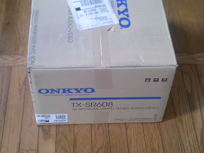

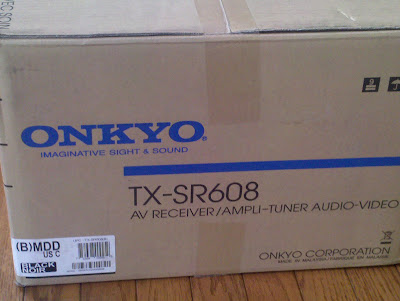

Quick update all. Just took possession of the 608! Very excited. Waiting on a couple speakers as well, so no setup pics immediately.
How are people finding the performance of the Audyssey 2EQ? I was hesitant initially to get the 608 because of this, almost opting for a 707 with MultiEQ or a new Pio 1020 with Adv MCACC. Can folks post a bit more about the quality of their sub sounds (since 2EQ doesn't apply filters) as well as the effect on your fronts/surrounds? Thanks!
Lastly, a couple pics:
