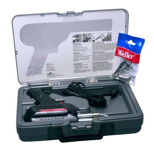

I seriously doubt you will be able to solder 8 gauge copper wire to those binding posts with an iron. The wire will conduct the heat away from the joint faster than the iron can supply it. You will probably need a soldering gun. Here is a suitable one:
Weller D550PK 120-volt Professional Soldering Gun Kit 260/200 Watts

All my soldering tools are Weller. Long lasting, well balanced and easy to use. I have a two iron WTCP station a single station and 2 guns.
The smaller 8200 has been the AV/industrial standard for 40+years. The 8200 is a 100/140 watt gun.
I also use the larger 240 watt gun for heavy cables and congested ground terminals.
