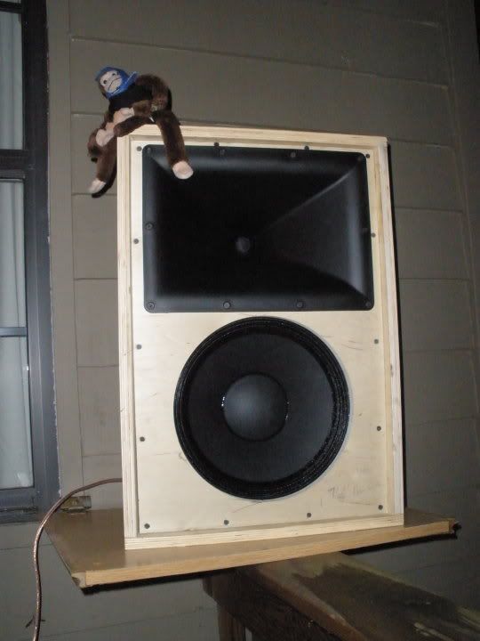

All was not lost that weekend, while waiting on everything (parts) to arrive prior to leaving for our trip, we'd build a pair of Zilch's EconoWave's that performed flawlessly for four days straight. I've really enjoyed these speakers.
