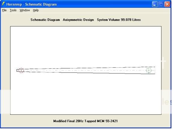

These parameters were slightly different than my originals but have been adjusted slightly due to folding which changed them a bit.
The schematic. It was kept at 3.5 cubic feet before folding.

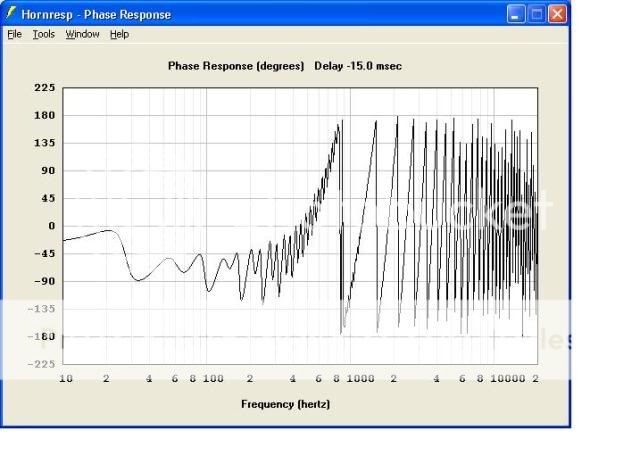

Phase response

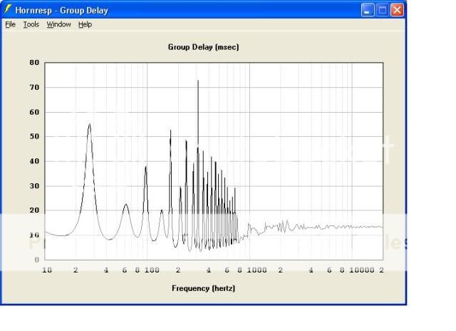

Group Delay

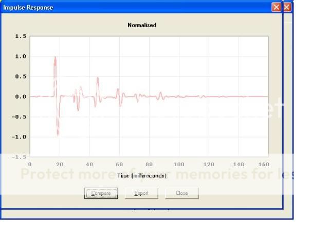

Impulse Response

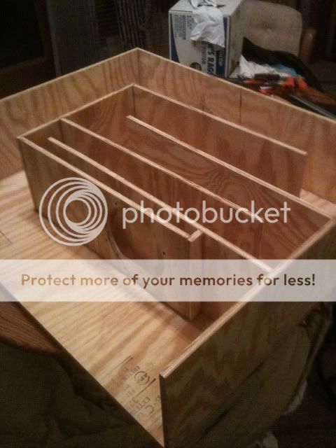

Here is the drawing in AutoCAD which makes it very easy to fold the horn. In this drawing the amp will fit at an angle in the upper left of the pic. The driver will sit directly next to it.
The enclosure is nearly completed at this point. It took a mere 3 hours to assemble once all of the pieces had been cut. The 1/2" plywood that I used is some inexpensive stuff from Lowes that was slightly warped that they marked down to $7 a sheet just to get them out of the way for them. I used the PL premium and a brad nailer which made assembly very easy. Highly recommended!!!

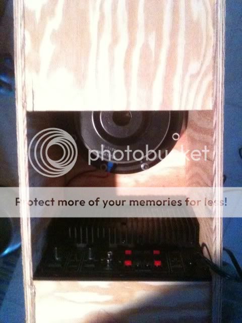

I really didn't want to stick an amp in my entertainment center so I built the amp into the box. I know that BFM strongly frowns on this but the amp is plugged into the same outlet as my receiver as well so no ground loop issues here. I also wanted to make the enclosure as slim as possible so I made it 8.5" wide internally. This required me to mill down the amp to fit. Good bye warranty!!
Here is a pic showing the driver and amp installed in the box. Note that airflow from the enclosure will also help to cool the amp, not that it gets very warm anyways. It's a very tidy slim package.
