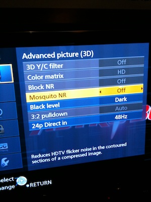

There's been a lot of debate about how the new 3DTVs display 24p 3D content. While we know Samsung displays 24p content at 120hz per eye alternating blank frames to reduce ghosting -- we assume Sony does the same thing -- but how Panasonic's displays do it isn't as clear.
The new VT20's on display at Best Buys will let you choose 48hz, 60hz or 96hz when watching 3D content, and with the limited demo material, it is hard to noticed any flicker. But there is still some debate as to if that is the per eye or the total refresh rate.
It seems unlikely that a Panasonic plasma can refresh at 192hz, but it seems just as unlikely that 48hz total for both eyes would be watchable.
I've requested an official response from Panasonic's PR team, but have yet to hear back one way or another. I do have a source who originally told me it was per eye, but now tells me the answer isn't that simple.

Finally had my call with Pannasonic's engineer yesterday and he explained that it is 96hz total, not per eye. He further explained that the UI is missleading and that the display options for 24p 3D content should be labeled 48hz, 96hz and 120hz (not 60).
It'll be interesting to hear if people who noticed flicker on 2D 24p content at 48hz will also notice it on 3D 24p content at 96hz, since it is the the same frame rate per eye, but not the same total frame rate.
post #13 of 38
That's what I thought, Ben. I do see flicker at 96hz. The Panasonic menus are confusing and misleading.

A friend and I went through this whole investigation on a Panasonic plasma with Panasonic Blu-ray player just last Friday (in a cooperative store).
The settings of "24, 48, 60" are definitely per eye, meaning refresh rates of 48, 96, 120 respectively. There is TREMENDOUS flickering in 24 fps content when 24(48) is selected. The flickering is so bad that you can actually see the goggles flicker if you take them off and just look through them at a lighted area.
The salespeople had no idea until we explained the situation to them. They said they installed the setup using default settings and thought that flicker was "the way 3D looked".
Note that in the Panasonic demo disk, they have actually arranged the menus so that the Blu-ray disk main-menu selections on the left (in larger font size) are theatrical 24 fps content (e.g. Astro Boy), where the selections on the right (e.g. Motocross) are HD video shot at 30 fps. All of the 30 fps content displays fine no matter what the set/BD player settings are, since it's always shown at 60(120).
If the BD player is configured for 24 fps, the TV won't let you change the display mode. This means that every time you watch a Blu-ray movie, you're going to have to toggle the player settings to turn off 24 fps, then ideally turn it back on to watch 2D content.
If you're trying to demo the Panasonic combo, make sure the player has 24 fps turned off, and the TV shows 60 Hz (should be the only available setting once the player 24 fps setting is disabled).
