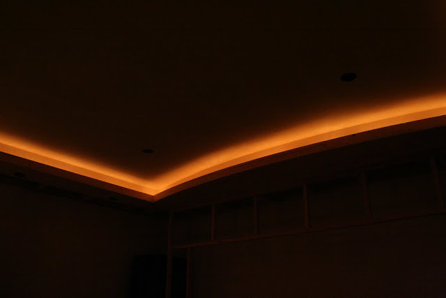

Soffit lights in, and filled the soffit cavities with insulation:
Testing out the rope light - trying to decide between one and two layers (one looks better I think), and placement (seems like against the inner face of the soffit, raised up about an inch gives a better diffuse effect):

Well...I started painting the ceiling a dark brown color from Lowes (Valspar) - unfortunately, after a coat of tinted primer, and two coats of the paint, it still isn't covered - and way more problematic, their "flat" paint isn't flat, has a bit of gloss to it, which when I add the rope light, really looks like garbage - blotchy light all over the place. Awful. I am pissed, I got my money back for the paint, and put up a couple samples of a similar color and also "Mouse Ears" from Home Depot (Behr), just to see if either of them will actually dry flat enough. Not very hopeful so far, although its not completely dry.
No way the "diffuse light" look will work the way I had planned - I'll have to shove the rope light toward the front edge of the tray and take the sharper edge on lighting on the ceiling. The position I had worked out that gave a nice diffuse effect when it was just white primer, looks terrible after the paint (blotchy light).

Here's a picture of the painted ceiling - also used the same paint to cover the soffit wood and the screen wall framing, so no wood will show through the fabric once covered. The color is Behr "Espresso Beans" - the darkest shade of brown that I could find, looks near black in the picture (and with the lights off, yay).
Rope light with the lights off.

That ceiling paint with your rope lights on looks awesome. Good choice.

Brad, the ceiling/light effect looks really good. Nice job.

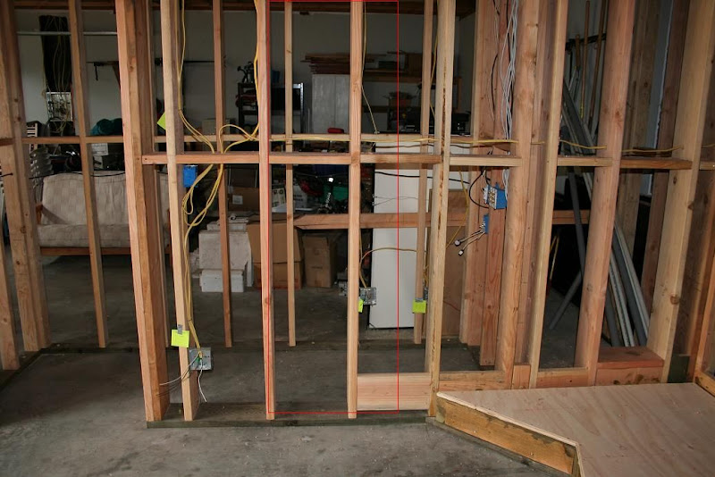

Here's my plan of the day: since I have a nice tall rack that I'm going to be using for two purposes (top: A/V gear; bottom: music gear), I'll leave a gap between those two piles of gear - maybe with a cover over the face - so I can reach through from the front to connect the rack to speaker jacks, HDMI jack, and ethernet jack. So if I need to fiddle with the wiring on the rear of the rack, I unplug all those, and then I can roll it out to work on it, and then roll it back and plug it back in. A bit of a hassle, but shouldn't be too bad.
Does anyone have good resources describing (a) best placement of components within a rack - primarily for heat dissipation (I've read the MA whitepaper, and it just makes my head hurt); and (b) "rack wiring for dummies" - what order to wire power, speakers, interconnects, how to make best use of lacing bars, etc. - to get a nice / clean looking result?
Also thinking maybe down the road I could build a removable panel to place around the rack in the closet so it looks built in (remove to roll the rack out).
