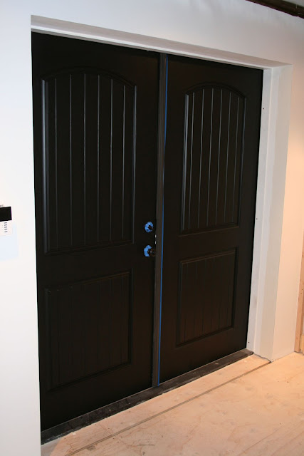

Inside of the entry doors painted satin black:

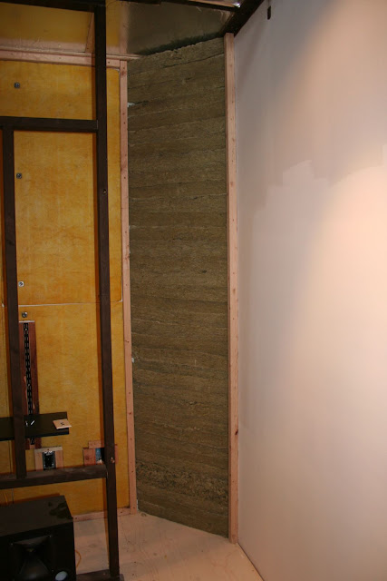

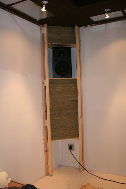

Right rear surround column / bass trap - used Roxul AFB, great stuff - cheap and super easy to work with with an electric carving knife. Framing is 2x2s, and 1/2" plywood speaker shelf. I plan on filling the bottom part with more AFB, but need to discuss the outlets buried in there with the building inspector - can I leave them and bury them, or move into the columns, or move outside columns. Same issue with all column locations.

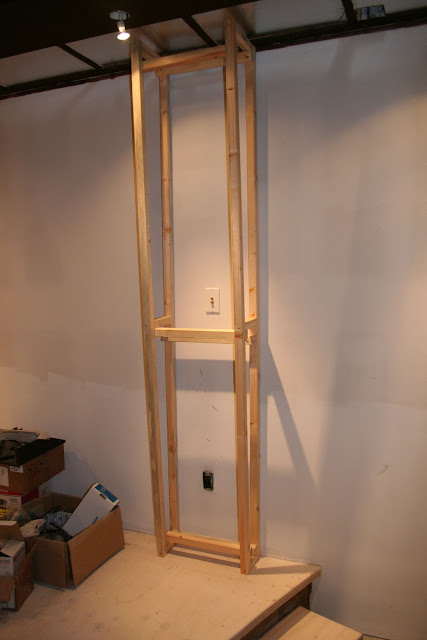

Left surround speaker column:
Right surround column, right rear column:

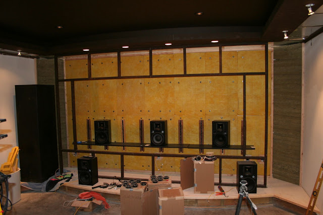

Screen wall - L/R superchunks, 1" OC 703, Rubbermaid shelving for LCRs (THT will either be upright in the corners, or slide under the LCR shelf on its side:

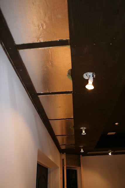

1.5" OC 703 FRK/FSK in the soffits, covering pink fiberglass filling. Boy sure is shiny, wish me luck not having that show through fabric. May have to paint it or use two layers of cloth, not sure.

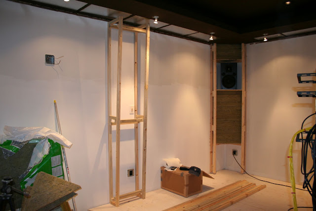

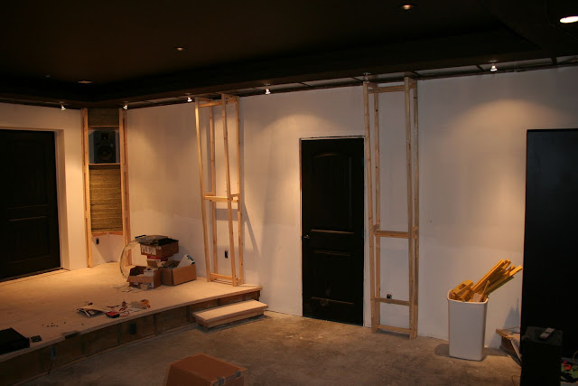

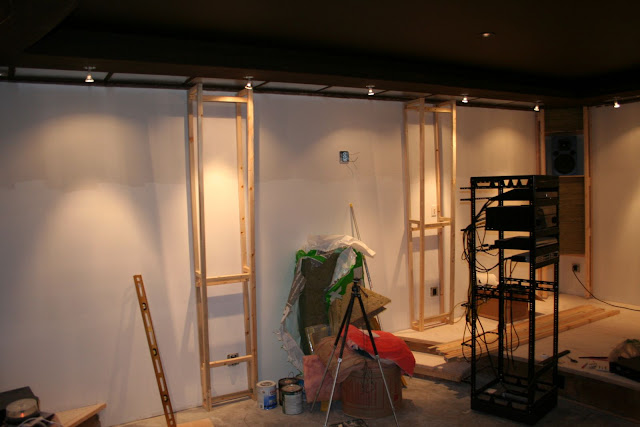

Left side of room, showing rear column, side column, and side front (dummy) column.
Right side of the room, showing columns and miscellaneous mess.

You may be fine with the silver showing through. Seems it might only show through with direct light, and your lights will look like they will be directly to the side, so only a camera flash may show it. You may have an issue if you have wall sconces that may hit the fabric directly.

No sconces, so no issue there - I guess I'll test with a piece of fabric and take a flash photo to see where I stand before stapling up the fabric.

Oh yeah, the corner traps were very easy - just screwed/liquid nailed a couple 2x2s floor to ceiling at 17" from the corner, and then load the AFB triangles - that's all they need for support. I bought an electric carving knife at Target for $20, and it made cutting the AFB a breeze. Each corner trap was probably a couple hours work.
I got the AFB from a local place in Anaheim that carries commercial insulation, called MacArthur Co. (http://macarthurco.com/) - they seem to be mostly West Coast, but some offices scattered around elsewhere. I found them by sending an e-mail to Roxul and asking for local distributors. The price was nice too, $0.71/sf for 3", so the material for all four corner traps cost me $91 plus tax.
