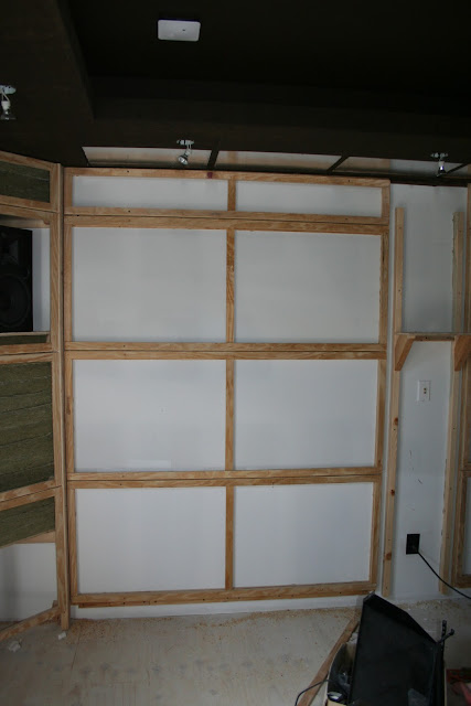

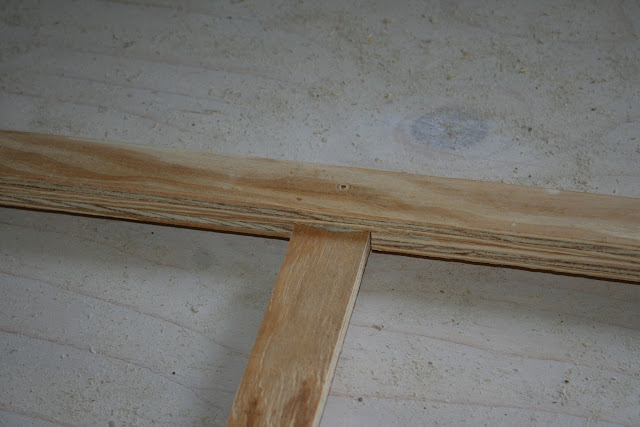

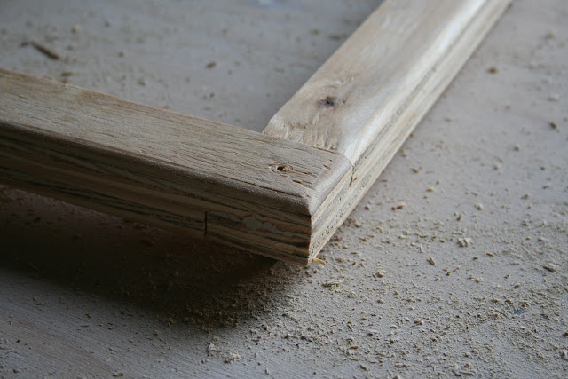

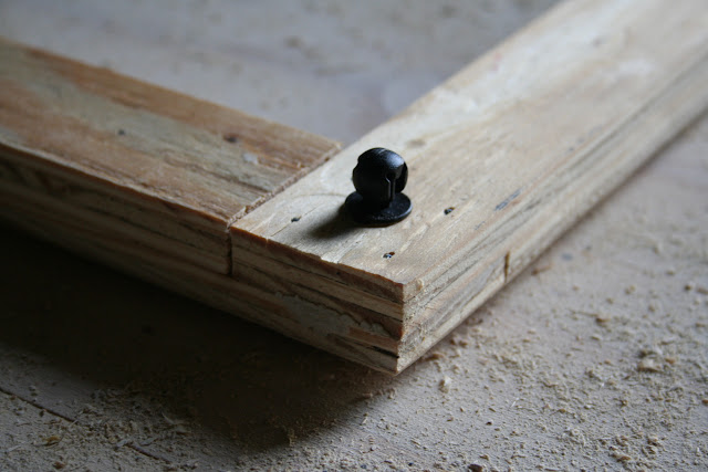

I received a request for some pictures of the panels, so here are a few more showing how I made mine. They aren't perfect by any means - cheap plywood had some voids that caused a little tear out here and there when routing, but hopefully the fabric will cure all defects.
Wall segment chock full of panels (well almost - haven't done the bottom part where it will meet the carpet, since not 100% sure on the height of the carpet and pad). Vertical bracing and shelf is where the column mounts, I took the columns down to prep them for fabric.

That panel removed, showing the ball part of the grill guides, and the corner lap joints.
Closeup of the lap joint, brad nails, some liquid nails squeeze out, and the ball of the grill guide.
Flip side of the corner - I used a 3/8" roundover - thought about going a little bigger, but router bits aren't cheap, so I decided I like it this way.
Cross brace on the back of the panel - I didn't double up the cross braces to meet the face like I did everywhere else, so as to avoid any possibility of the bump showing through the fabric.

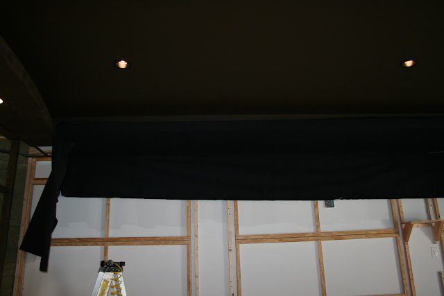

Got started on covering the soffits with fabric (black 16 oz Commando Cloth) this weekend. I started with a Harbor Freight combo brad nailer / narrow crown (1/4") stapler that I borrowed from my neighbor, but after about 6' of soffit, it started jamming, and then lost pressure, couldn't figure out how to fix it. Looks like I owe him a new one. So I went to HD and picked up a Porter Cable narrow crown stapler, and that has worked great.
Here is my temporary fabric cutting station - I had the triangle scraps sitting on the ground already, just screwed them to a 2x2. Notice the nice fist sized stain on the right side of the roll, goes all the way through apparently - would have been pissed, but (a) I didn't need the full width, and (b) it was far cheaper at $3.99/yd than anywhere else I found.
This stuff is extremely opaque, so there was no need to worry about doing anything to hide the reflective foil on the FSK. Its not real good at the blow test, but since I'm using it over bass trapping, not too concerned. Its also quite heavy, so required some muscling around to get it tight across the wide soffit underside - hope it doesn't sag over time.
First step was to hang the fabric up onto the tray edge using big binder clips - had my son help hold the 24' length of fabric while I clipped it up. The camera flash really washed out the colors, the ceiling is very dark brown, and the fabric is black.
Started stapling at 1" from the top of the tray edge (will cover with some black trim), and then to the furring strip at the edge of the soffit where it meets the wall. I will glue down the strip of fabric above the staples and over the tray edge top - not sure what glue to use yet, don't want overspray, so 777 is out. Maybe just white glue. Or contact cement.
