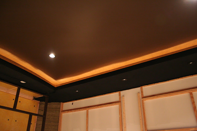

Pics! Here's a few pics of the soffit as of night before last - still a couple places where I need to trim and tuck and such, but its getting close. The uneven shadows in the rope light are because there is still some fabric sticking up on the inside of the tray that I either need to trim off with a utility knife or glue down or both. I wonder if a glue stick would work, or maybe just a bead of white glue - don't want to do the contact cement back there, would be hard to work inside the tray.
I added the eyeball trims on the screen lights last night, but didn't shoot a picture of it.

Hey Brad - looking good! Quick question...
How far out in front of your screen are those screen lights? Is there a generally accepted distance? I'm trying to locate mine now and I have a joist that's kinda in the way....I'm probably going to end up at either about 4" in front of the screen or 18" in front...

Thanks Ben, the center of the fixtures is 8 3/4" away from the face of the false wall studs. So once the panels are around the screen, it will maybe an inch less then less. As far as guidelines for positioning, not sure, I just eyeballed it best I could, taking into account the curved face of the bulkhead. Pretty sure there are general guidelines for light spread, etc., but not sure what they are. For the soffit lighting (sides, back), I remember reading and applying some rule I saw, same with the tray depth.

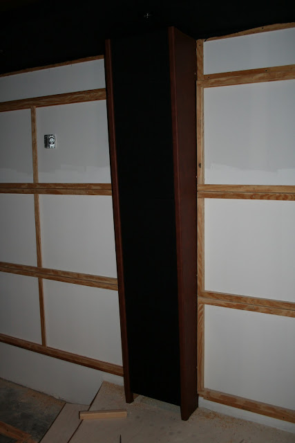

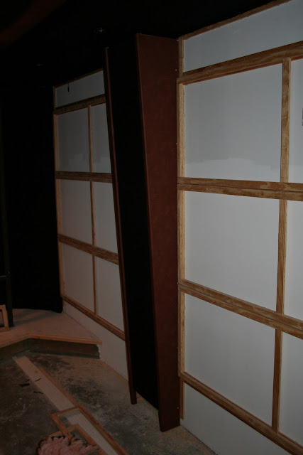

Last night I had precut some of the vinyl I'm putting on the column sides, and couldn't wait to try it out - so I had at it on my lunch break, managed to get the sides of two of the columns done - the stapling for these sure goes quicker than the soffit, much easier to handle:
I stapled on the first side before I started taking any pics of the process:
From the start - cut a panel a bit oversize to allow for wrapping/stapling:
stapled the inside edge:
flipped it over and started pulling the material tight and stapling:
done stapling all around:
trimmed off excess, and used xacto knife to cut holes where the mounting screws on the sides go:
right side column done and test fitted:
left side column done and test fitted:
Not screwed down yet, because (a) they will need to be out of the way when the carpet is installed, and (b) I need to cut an inch or so off the bottoms to clear the carpet / pad. Shouldn't be too bad, add a piece of bracing a little higher, cut away the vinyl with xacto knife, and then saw off the bottom. Trim will be covering top and bottom.
Will also need to sand the face panels some, as I didn't leave quite enough clearance for the vinyl and speaker fabric in the nooks.
Fun!

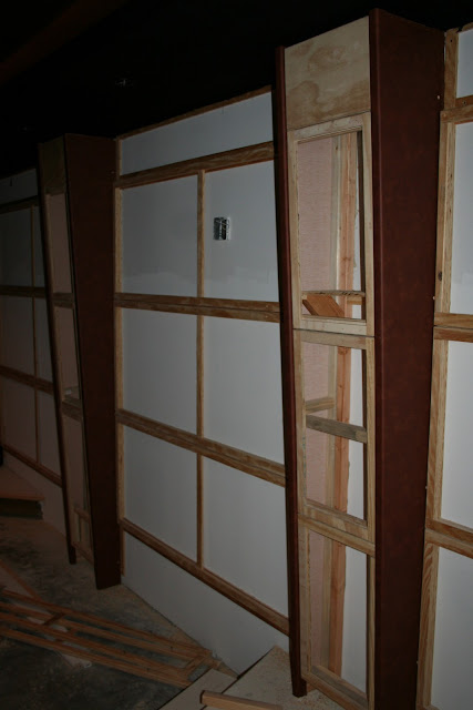

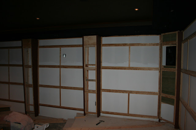

Finished up the rest of the column sides on Saturday - here are the front and side columns, with the face frames in place (spent a couple hours today belt sanding the edges to make them fit after the vinyl was added):
rear corner columns:
all of the right side columns:

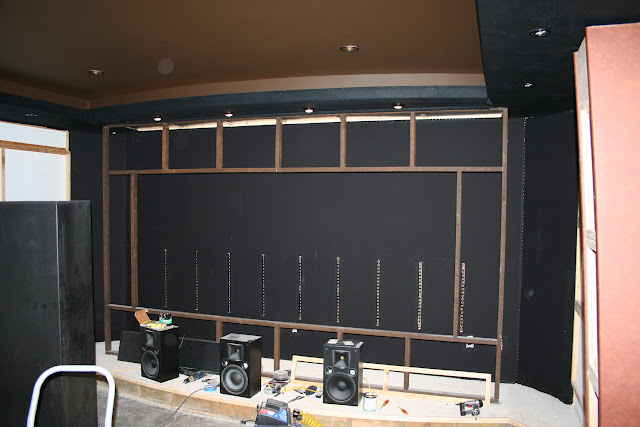

Saturday afternoon, I got the black speaker fabric up over the OC 703 behind the screen wall - the speaker cloth is 102" width, so no seam, covers top to bottom (well except the part on the lower left where I accidentally ripped the fabric, and had to put a patch over it - oh well, its behind the screen wall, so I didn't care enough to do a pretty fix). Looks a bit smudgy, I need to go over it with a lint roller I picked up at Staples:

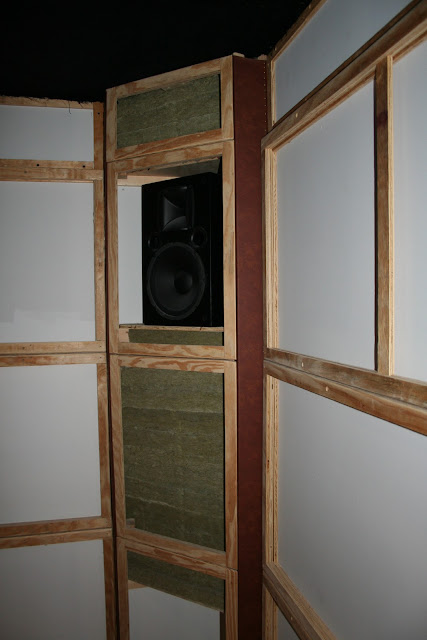

The LCRs sit on Rubbermaid adjustable shelving - the shelf support rails are attached to vertical 2x4s laid flat, with channels routed in them - allowed me to attach the fabric to the 2x4s after I cut out to expose the rails - edges of the fabric are glued to the inside of the channel with contact cement.
Closeup of channels that the adjustable shelf supports sit in (may need to touch the gold screw heads with a sharpie):
