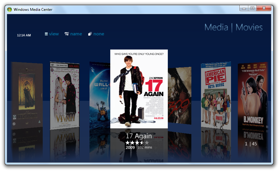

I am just getting my HTPC set up and have been reading and trying to understand how to get everything going.
I would like to use 7MC for everything if possible. Right now I just have a bunch of movies that I got from a friend but they are all in avi and mp4 format. What format do I need the movies in so it will bring up all the info through 7MC with synopsis, coverart etc? I already downloaded media browser, but when viewing the movies in 7MC they are all just colored tiles with the title.
How can I get it to look like this? http://www.redmondpie.com/wp-content...ediaCenter.png
Do I need to convert the files to something else besides avi or mp4?
I want to start ripping the DVDs I have as well, what is a good easy to use program to do that? Free would be nice as well.
Thanks for the help

You can have any format you want (avi, mp4, etc...). I would recommend you use a plugin such as MediaBrowser or MyMovies for W7MC which will give you multiple views along with coverart/fanart.
post #150 of 4573
I already have media browser installed, but no cover art or anything comes up
