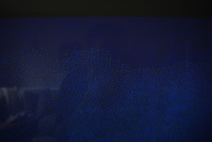

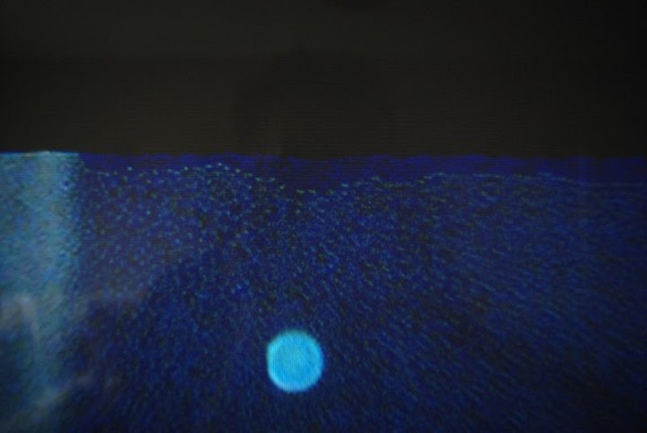

Just took delivery of my 60PK950 today. I noticed something that is quite distracting and I'm not sure if it's just how these sets are or I have a defective one. I've noticed in darket scenes that there are what I can only describe as very noticable sparkling pixels - green or blue. On dark scenes these can be readily seen from as far as 5 - 6 feet and from a little closer you can actually see the lines they follow on the screen. The really weird thing is right near the border of the screen (or picture if vieiwing letter boxed content) they disappear and that is what is visible even at regular (in my case about 10.5 ft.) viewing distance. After awhile it was all I could see and it was very distracting. Does anyone have any idea what this is or seen anything like this?
edit: adding a couple of photos I took this morning. granted the quality isn't very good but it clearly shows the issue, which is better than trying to describe it. In the first one notice both the blue pixels (along the line of the image border - black bar above) and the green pixels as the image lightens.
Hi JN , i have the exact same problem with my set ! I just wanted to ask if u might've found a solution. Is this problem big enough to be able to return it. To me it's a damn shame, i went from lcd to plasma to have the better black levels. They are better, but, these artifacts completely ruin it for me. In my case they are very blue though...
Any solutions ??
Any solutions ??
I did not find a solution and I have had 2 sets that underwent considerable tweaking as well as spent time with two others in the store plus a 550 and PX950 3D model. They all had the problem.
For me it's something I can't live with so this second one is going back (screen's chipped on a corner anyway) and I am switching to Samsung. From all the tweaking I did I came to the conclusion that it's a general flaw with LG plasmas and not a defect in just some sets and some people don't mind or notice.
You can minimize it by lowering brightness but you lose shadow detail (and the the problem just shifts to darker areas of the image) or you can increase brightness so it's more uniform but then you'll have a washed out looking picture (like the THX bright room setting). Lastly you can play with the 5 IRE settings in the 20 pt. IRE adjustment and see if that helps.

looks like plasma dithering... which is pretty much common on all plasmas. switching to Samsung won't help. I have a Samsung Plasma and it is the same thing. Although some higher end plasma minimizes it better. Try lowering the contrast.

Very likely all you need to do is slightly lower your brightness setting. I have the PK550 and see exactly this effect shown in your pictures if I have the brightness slightly too high. Set up the set like when you took the picture, then slowly decrease brightness one click at a time. When you get to the point where it is supposed to be all the sparkeling pixels will suddenly disappear in one click. What you are doing, actually, is setting the black level to 16, it is a basic step in calibration. The LGs are very sensitive in this adjustment.

I've had the dancing green pixels as well, but they were never a problem due to my viewing distance. That said, the advice by rpauls absolutely works. I just tried it and one or two clicks down on the brightness was all it took to eliminate them.

Doing this only moves the green dots to darker sections of the scene - they cannot be elimintated. Additionally, getting them to an acceptable level, i.e. not seen from normal viewing distance requires brightness to be dimmed too low, beyond where it shodl be to produce accurate shadow detail.
Living with this set required too big a compromise with pq for me so I moved on to a Samsung C8000 series and couldn't be happier.

Contrast is a matter of personal preference, but brightness is not. There is only one correct setting for brightness. Strictly speaking it is the setting when an input value of digital 16 looks as black as all the values 0-15 do.
It makes little difference what other people's brightness is set to. You have to adjust your own set. Every one will be different. If you don't have a dvd with a test pattern simply put on any dvd that does not fill the entire screen (black bars at top and bottom), push pause (optional), then adjust the brightness until the sparkling effect just disappears from the black bars above the picture. This is your optimal brightness setting.
FYI, it tends to be in the 46 - 52 range on this set.
