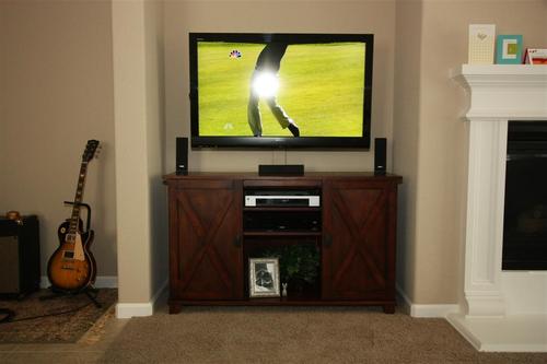

hey i did a search in this forum for some help but couldnt seem to find what i was looking for. i dont know if this is the right section but here goes
i recently picked up a pn58c8000 and my current center channel is too tall sitting in front of my tv and i am wondering if there is someone who makes a feet or some kind of riser to put under my tv so it will clear my center channel. if any of you have some advice that would be great. the extra feet that come with the set are just a bit too short

I was thinking about just getting a block of wood (and painting it black) so that it would raise the TV a few inches but instead I just ended up placing the center speaker behind the TV.

Yamifanatic - I had the same issue and put the center channel behind the screen. At first I could not imagine it would be acceptable, but it is. Sound is fine and I actually don't notice the speaker back there now.
post #3831 of 5830
I spent waaaaay too long looking at options for this. I ended up buying a CRT TV mount from VMP (Model 003B), mounted it above/behind my TV, and then put the center up there. (It kinda looks like the speaker is floating up there, but it looks good. I also have my wireless router there too since it is a high point and hidden.)
Below is the results of my research... (With embedded links to most of the products. The links all worked Sept 2010.)
The easiest thing would be to buy a stand/cabinet that had a space for the center. But unfortunately we already had a TV stand/cabinet that we bought from Sam's Club that didn't have a location for the center. Thus the list below...
Here are a couple of the better options that I saw out there...
I think it might look odd to have a speaker floating above the TV... The face of the speakers should be in the same plane as the face of the TV.
I do like the TV height as it is now... Option 1 would put the TV 6" higher than it is now... Option 2/3 would put the TV 10" higher up than it is now. Option 4 would leave the TV at the current height since the speaker would be above the TV.
Speaker Below TV Options
1) Buy a mount for the TV and put it just high enough above the entertainment center so that the Speaker will fit. The wall mount will have to put the TV 12 to 16" from the wall so it will look exactly as it does today.
Cost ~ $75 to $100
Kinda like THIS or THIS
Or maybe THIS (CHEETAH MOUNTS / VideoSecu Articulating mounts / Might need 16" stud centers.)
2) Build a stand and stain it to match the TV cabinet.
Cost ~$50 and DIY time
Kinda like THIS
More pix HERE
3) Buy a stand that matches the TV cabinet. (This example comes in 10+ colors. )
Cost ~ $100
Picture HERE
Colors HERE
Speaker Above TV options
4) Buy a CRT TV mount or Shelf and put the speaker *just* above the TV. Could put other stuff up there also...
Cost ~ $50 to $100
Example HERE
Another above TV shelf picture HERE
HERE is what I ended up getting. I got the double arm one so I didn't have to center the TV on a stud or place the TV at a certain distance from the wall. (This mount allows quite a range of distance from the wall and off angle while still allowing stud mounting.) Note that you can bend back / cut off the bottom front edge so it sits right above the TV. My center speaker screen hides the top edge since I put the lip between the speaker and screen.

Originally Posted by junkmail View Post
That could work, I'm sure you can find a good solution at IKEA if you're going for the modern/contemporary furniture look. If you want a really clean look, perhaps a new entertainment console might be consideration?
I ended up putting my soundbar speaker behind the TV because I didn't want it to block the aesthetics of its metal stand. The stand matches my TV cabinet (from BoConcept)
