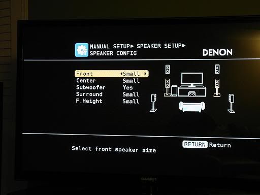

Hi. here I am again as I haven't figured out how to remore the fullband setting of my speakers. Can you please check out the parameters and tell what do you think ?
Denon AVR-891
Polk M70 front
Polk CS20 center
PolkM20 surround
sub is Polk PSW505
cable box: videotron illico explorer 8642 HD
TV: Samsung 59" plasma & 3D
OK....here I go. I was told I should not have my speakers to "fullband"
so what I did was :
I go to manual setting
Then I go to Speaker Setup
Then I go to Speaker Config
Then I get this:
Then I go to Bass Setting
then I get this:
then I go to Crossover Frequency
then to check if everything is OK, I go check my parameters:
I go Menu , then I go auto setup , then parameter check
I go Speaker Config Check and I get this:
why are my speakers still Large ??
then I go Crossover Check and I get this:
Why everything still fullband ?????????
can you please help me get the best of my system. be gentil... I am a slow learner... Please if you know my problem, try giving me step by step instructions.....
thanks in advance
stef
post #4428 of 4873
Hi stef, you don't have a problem. Paramater check is showing the settings set by running "AUTO SETUP". The settings in "MANUAL SETUP" is showing what changes you made which are what is active. Suggest setting front crossover to either 60Hz of 80Hz.
post #4429 of 4873
Ho I'am soo happy now.... I worked and worked on this so many times thinknig I had a problem.... hap I will put front at 80 ( don't know why it's not there already... )
1000 thank you. I love this place...

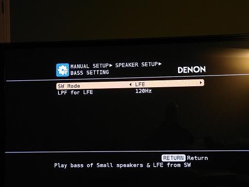

also is LPF to LFE at 120 good ?? in picture #2 ( chinese to me... hehe )
stef

post #4431 of 4873
Let me translate that for you ... yes, you're good at 120Hz .
