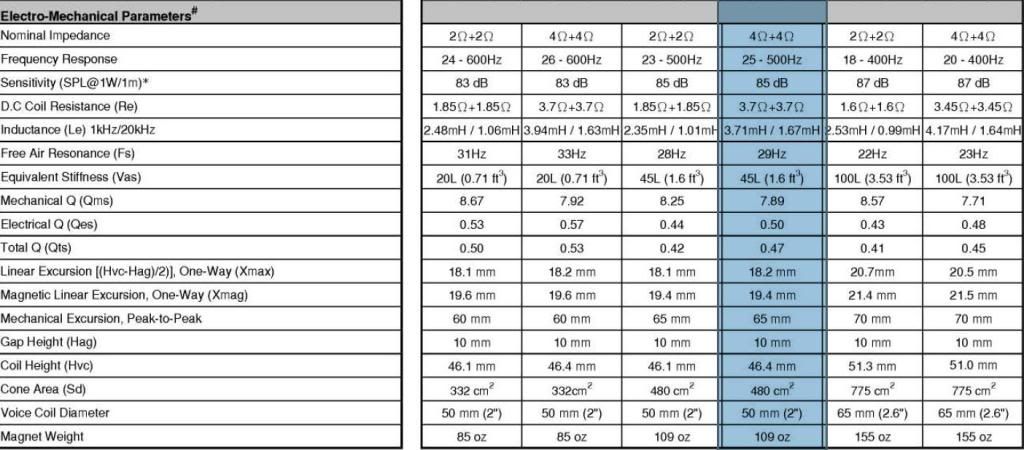

Well the way it was made the back was screwed on and I was listening to a 30hz tone and it just popped right off. So anyways I need to make a new one. The subwoofer is an alpine type r. The box was a ported 18" cube, but I want to make a sealed one becuase ported just sounded terrible at some frequencies. If I would plug the port it would sound much better. So anyways, about how many cu ft should it be? Here are some specs, highlighted in blue.

Download a copy of WinISD. You'll be able to play around with sealed/ported and size of box to determine what will be best. Read the getting started guide in help and make sure you follow the suggested procedure for entering new driver data.

Edit: I just sim'd it a little and a bandpass box doesn't suit it too well. You'll get the same SPL as ported, and poorer frequency response. For a ported box, 100 liters (3.5 cf) tuned to 22Hz would be nice, -3dB point would be 20Hz. For music this will require no highpass filter, but for movies it does. Trouble is, such a low tuning requires a lotta port area if you don't want it to chuff. And with a lotta port area comes a lotta port length... I think that you should try to build a slot port inside the box rather than bending lengths of pipe to fit inside the box (been there, done that, not fun). Can you give me at least one fixed dimension for the box? I'll try and think where the port would go.

I sim'd a sealed box too and it doesn't look too good unless you have LOTS of room gain (ie: a large room with little furniture). A sealed box would do fine in a car, but for home use ported is definitely the way to go with that sub.
