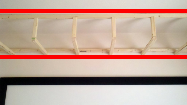

A quick update on my theater room. The soffit is coming along nicely. Its all framed out and ready for sheet rock. I was planing on using 1/4" sheet rock to keep it light, but I'm convinced this thing is sturdy enough for 5/8".
I have my sights on pot lights and rope lighting, I'll keep you posted.

I'm planning on starting the drywall on the soffit today. I have a couple questions...
What is the best way to tape and mud new drywall with existing drywall??
When I took out my chandelier, I cut back the existing drywalls paper back giving me room to tape and mud. Should I do this around the soffit too?? The areas marked in red in the picture show the areas I would cut and strip down to paper, giving me room to tape and mud. Would this be the correct way to do this??
Or, should I just tape and mud over the existing texture and paint??

Not in my theater room but in another bed room I just finish I went back and redid some muddying to smooth some sections out. It was already painted. I just spread the mud on and sanded. Didn't cause any issues. After repainting you can't tell at all. You could just sand a little and tape as normal. Shouldn't be a problem.
You know you can use MDF on your soffits? Or other wood if you like. I built mine in 1/2 MDF after framing them like you did. If your room walls are already done I would avoid the mud, tape, sanding rout if it was me. It is such a pain in the arse!

Here is a quick mockup I did tonight, it turned out looking very good IMO. Please give me some criticism, do you like it, would you use MDF instead??
How is the crown molding held in place? Is there a brace or gusset behind it attached to the top of the piece of drywall in some way?
post #79 of 326
As you can see in the pcture, just to the left of the mockup, the 2X2. The crown moulding will be nailed in every 16 inches. The moulding is a foam form, very light weight. I think it will be ok without a gusset, what do you think??
I have a sheet of 1/4 inch masonite, I could lay that down across the 2X2, giving my a brace/gusset that could be glued in place. That would give me a place to install rope/black lighting too.

You do not need to strip down any paper with paint on it, but if the ceiling is textured you should scrape it down and sand it a bit so when you mud the seam, it is semi flat, then you can reapply the texture back as needed.
As for the crown, if you are using a brad nailer, I would use some reinforcement on the back of the crown in the form of one of those 2x2's you have. Brad nailers rock for wood trim and dont pull out, but the foam, it can come loose. Granted, with the corners of the room supporting each othere where the crown meets, you just need to worry about the long runs in between.
btw..I love how you made the soffit, very functional!
Actually, if it were made of wood, it might be okay. But foam, ehhhhh, not so much.
I'd maybe throw another 2x2 across the tops of all those protruding 2x2s and really get some backing behind that crown. As it is, it could either sag down between the supports, or those brads could push too far through the foam and end up not providing any support at all.

Thanks for your opinion Drew_V, but I'm sure the foam molding will be fine. It's very light weight, and the way its made leaves no room for sagging. I have yet to commit to my mockup, just throwing it together to get some opinions and pointers.

FWIW, this framing is similar to how I did my soffit in my basement and the I had drywall crew hang and they just finished. This is not the ideal way for framing as it doesn't provide a consistent edge for the corner bead at the bottom for the finished product. My work wasn't perfect and I had edges that ran over 20'...this showed the 'waves' when the corner bead was put on....we'll see how the crew finishes to hide my framing sins. bottom line, I had to reinforce the braces as they had 'twist and play'. When I get to my theater, I will change the way I frame the soffit.

I plan to use my laser level to ensure the edges are square. Mine are only about 11' long so it should turn out ok in the end. The crown molding will hide my imperfections nicely.
I plan on building another mockup this weekend. Need to brace that crown molding better.

Here is another mockup of my soffit. I still plan on using a different method of installing the crown moulding (reinforced) . This picture shows the pot light I will end up using in the finished product. I really like how the bulb is recessed as opposed to the earlier light used in the pictures above.

Here is a new and improved mockup with crown molding support. What do you guys think?? I'm only hours away from kicking off the soffit sheet rock installation. Input would be great! I'm going to use bull nose corner bead around the edge.
Please give me some feedback.
