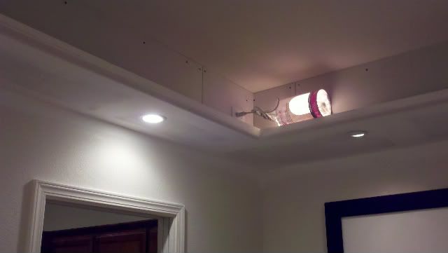

Well, another busy day in the theater room. Finished hanging the drywall for the soffit. Wired up the Grafik Eye (Have no idea how I'm going to stuff all those wires into the gang box), wired up the electrical outlet in the soffit for the rope light.
Waited all day for the texture guy to show up, said he'd be here at 8:30am, didn't swing by until 4pm. I about called him and told him to forget it... Glad I didn't, he quoted me $200 for the texturing... Even all my patches!! Said he'd be here 9am Saturday.
Well, here is a couple progress pics...

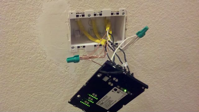

Here is a pic of the Grafik Eye, notice the patch job to the left. I must have read the Grafik Eye 3000 Series PDF wrong, could have sworn it said 4 gang?!?! Any suggestions on how to shove all these wires in that 3 gang box?? 12/2 Romex is extremely sturdy stuff, especially in wire groups of 4+.
Here is a pic of my "Bucket-O-Rope Light" plugged into the new soffit wall socket.
post #117 of 326
Looking great! For the wires, just bend them accordion style, they should all fit. $200 sounds reasonable. I don't know if you have ever considered doing that yourself also. I've done it several times and it is actually pretty easy. I bought a hopper from harbor freight for $15. of course I already had a compressor. But for $200, it's nice not to have to deal with the mess.
post #118 of 326
Thanks Badgerpilot,
$200 is a good price for what needs to be done. I've put a lot of time and effort into taping and mudding... I must say, it is an art. I trust myself mudding... Just not texture. I will watch him, not even sure I'd ever need to do it.
Thanks for the tip on the wires... I chose the deepest gang box, but I'm not happy with the rigidity of the wires. I'm sure it will all fit... eventually.
The Grafik Eye is quite the sophisticated light switch. Reading the instruction (the English version... clearly states 3 gang. FML), their are so many things you can do with this thing, zones, scenes, fade time, fade off. It AWESOME!! So glad I purchased it. Athough I wish I got a 4 zone.
post #119 of 326
Your problem is you left too much wire cover in the electrical box. The sheath of the cable should end just beyond the electrical box's clamping system.
Then you accordian the wires after tucking the ground and return bundles into the back of the electrical box.
