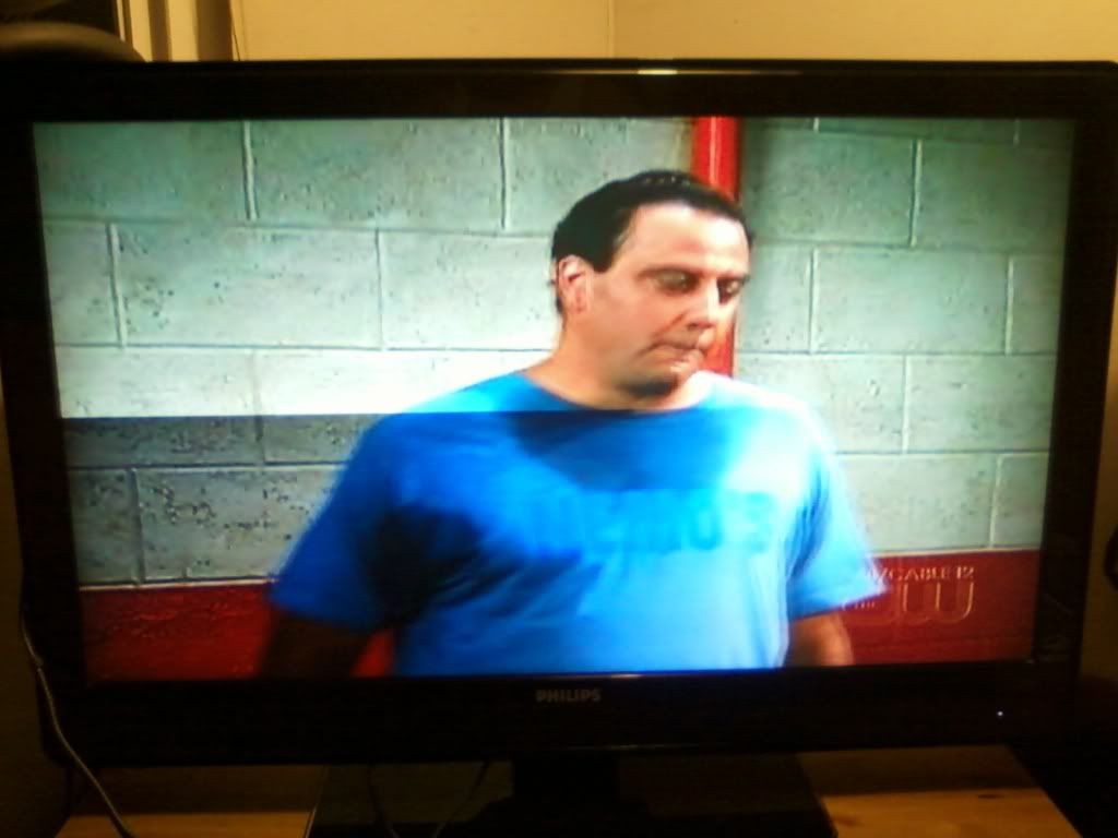

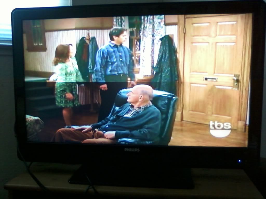

Hello, im pretty new here and i was wondering if anyone can shed any light on my situation. Any help would be appreciated.
Well my uncle bought a new tv to replace his messed up old one. He let me have his messed up one because he didnt want to deal with it anymore. Well its a Philips LCD TV model 42PFL3603D.
The major problem with the tv is that there is a horizontal line in the middle of the screen. Everything below that line is darker than usual and everything above the line is fine. I was wondering if there was anything I can do before I get repair quotes from various places.
The minor problem is that the tv doesnt respond to the remote.

Huh, I would get the service manual and start with power supply rail checks... some of these LCD TV service manuals still provide various signals’ shapes and amplitudes – this will help pin-point the problem (you’ll need the CRO)… it seems to me that the T-CON board needs to have the contacts' cleaned. I'd start with contacts between AV processor board and T-CON board...This fixes around 30-40% of all problems in these TV's.... If this does not give any results, try replacing the T-CON board... If that TV model uses TAB process (between T-CON and LCD panel), it could be TAB problem... I am not sure if you understand what I've just mentioned above... if you don't - get the service centre to help.

I'm thinking bad panel. Could be a board but I doubt it.
